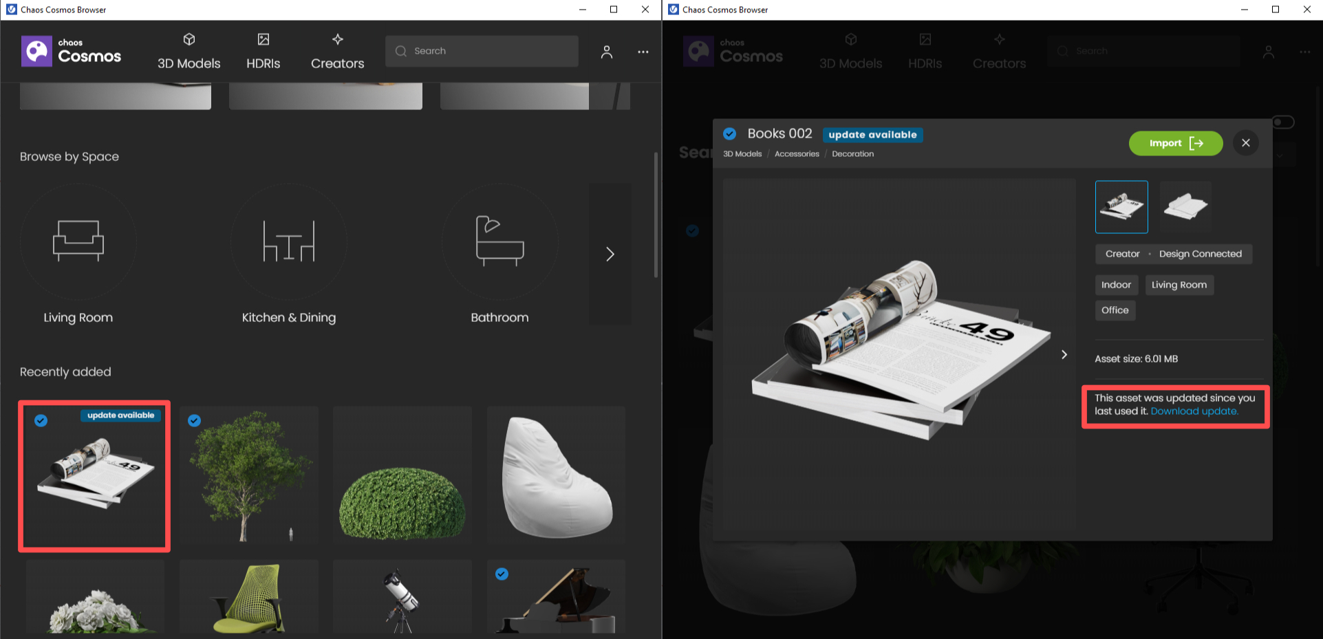

        Updating assets is done manually. You have to navigate to the asset you wish to update (Books 002 in this case). You'll see an "Update available" label over the preview image.
        You then have to open the asset details, where you'll find the "Download update" button. See the attached screenshots.
        After the asset update is downloaded you just have to press the "Import" button and the updated asset will be imported into your project.
        I hope that helps.
        Tsetso
