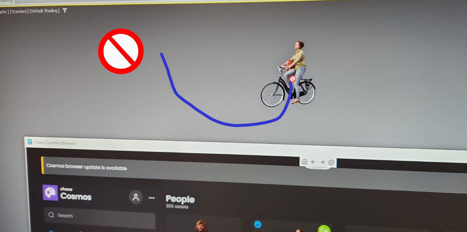

    I couldn't figure out the way to drag objects from the cosmos.
    Sometimes it works and sometimes it doesn't.
    Would appreciate help.
    Thanks​

      I use Max 2023, vray 6,windows 10. I am attaching a screenshot to show what happens when I drag
      A model from the cosmos. I wish I could tell when it works and when it doesn't - right now it's random for me​
        Thanks for escalating this. I have few other questions:
        • Does it happen with the same model? As seen from the screenshot, can you confirm that this bicycle sometimes imports and sometimes does not, via drag & drop?
        • Do you drop the model on the same place every time or random?
        • Do you experience the same issue with the [Import] button? Or in other words – does import using the button works 100% or not?
          Thanks.
          1. When it doesn't work - then it's with all models and not just a specific model
          2. reset Max ( without exit Max) - doesn't work
          3. Exit Max and reopen Max- working
          4. import button work 100% for all the model
