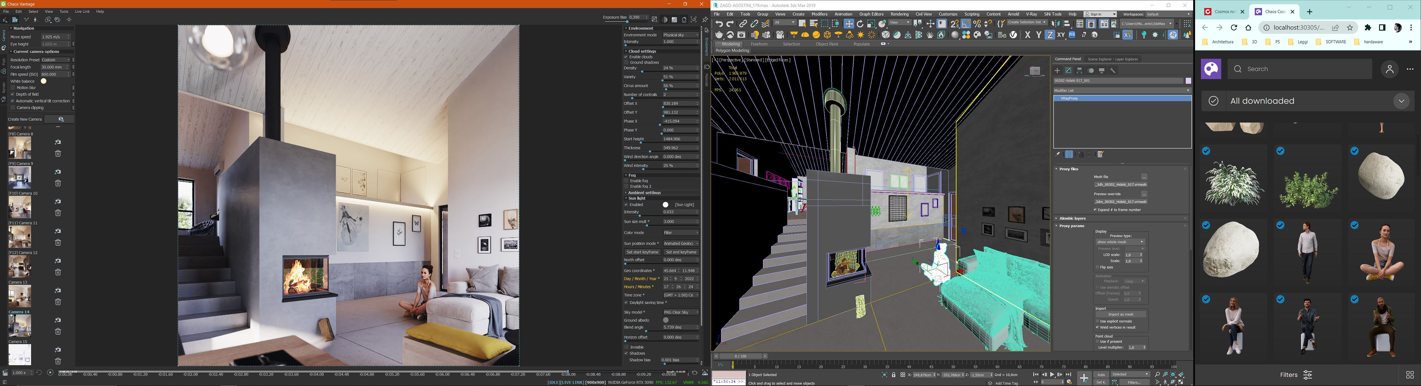

    if I try to open Cosmos through 3ds max icon nothing happens, if I open a live link to vantage Cosmos icon doesn't even show in Cosmos itself... (1st image below)

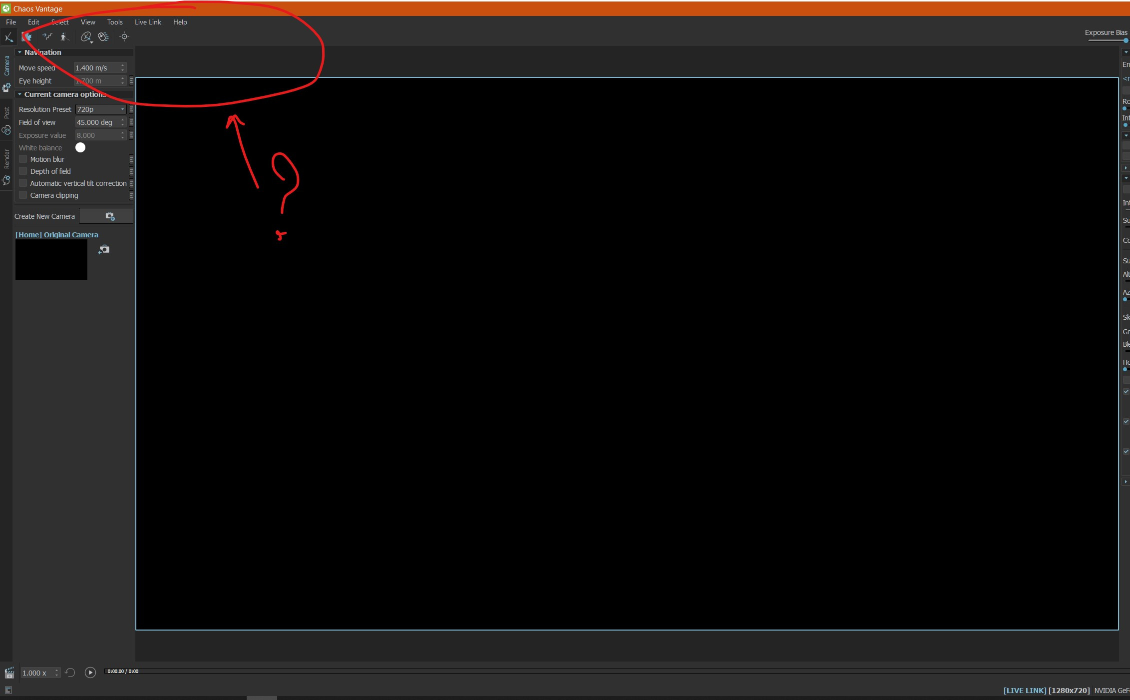

    if I open Vantage in standalone it does shows and opens Cosmos correctly... (2nd image below)

    Parts of the Vantage UI, including Cosmos, are disabled when Live Link is active. This is because you're not supposed to change the scene inside Vantage (except moving the camera). The connected app (3ds Max) is the one controlling the scene. Making changes in Vantage would lead to conflicts and loss of these changes.

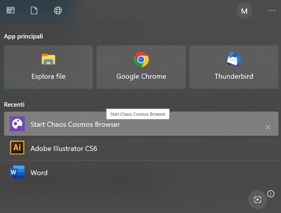

      even if I search cosmos browser and try to lauch it directly in wondows nothing happens
