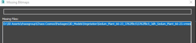

    This is a common, but not frequent, issue I have with the Cosmos Assets.
    Opening an existing scene brings missing file warnings, almost crashes scene, V-Ray messages about failing...etc.
    I found that for some reason, the assets have been renamed. Is this going to be something I need to watch out for in perpetuity, or was
    the name change accidental?
    Thanks a lot
    Click image for larger version  Name:	Screenshot 2024-02-14 103121.jpg Views:	0 Size:	17.9 KB ID:	1202006
    Click image for larger version  Name:	Screenshot 2024-02-14 104126.jpg Views:	0 Size:	62.2 KB ID:	1202009 Click image for larger version  Name:	Screenshot 2024-02-14 103036.jpg Views:	0 Size:	77.3 KB ID:	1202008

      Hi all
      1. We don’t rename assets. Asset resources (textures, etc.) contain a hash in their names which is different for different versions of the asset. Assets have versions. Sometimes we publish updates, which is the case with this Sedum Plant 66-23. It has two versions (revisions).
      2. We don’t remove assets, unless there's explicit request from a (ex-)partner to remove their assets. If I'm not wrong, this case occured only once in the history.
      voltron7: There's a chance that you've created your scene a while ago, using the first revision of this asset, then updated this asset to its latest revision and explicitly deleted all old revisions of assets (to save disk space), or you deleted all downloaded Cosmos assets and then downloaded the new revision of this asset. How old is your scene?​

          I don’t know why there isn't official statement from us in that topic. Apologies. I will escalate this.
            As Hristo Chakarov mentioned - there could be some old scenes with old revisions that are problematic to restore.
            Still, there are some improvements possible and we will try to get them included with the next update.
            Could you please specify the V-Ray version you are using and the creation date of the problematic scene, so we can do some checks?
            In any case, it will be very welcome if you can send us any scene where assets cannot be relocated/rebound.

                    Sorry for the late reply. I've sent you a DM voltron7. V-Ray for Max should take care about downloading older Cosmos assets, but obviously something goes wrong here. I sent you instructions how to download the missing revisions in order to restore your scenes.
