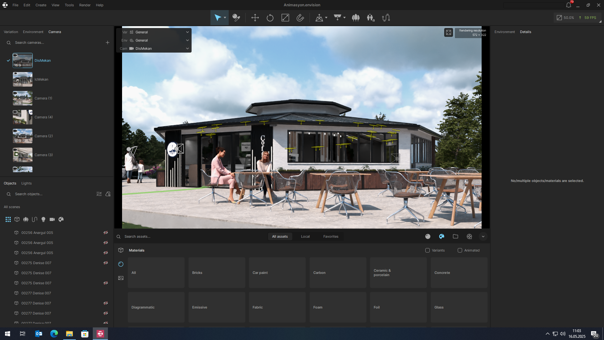

    Chaos cosmos materials are not there in envision.. I can reach 3d models, but "presets" section is empty..
