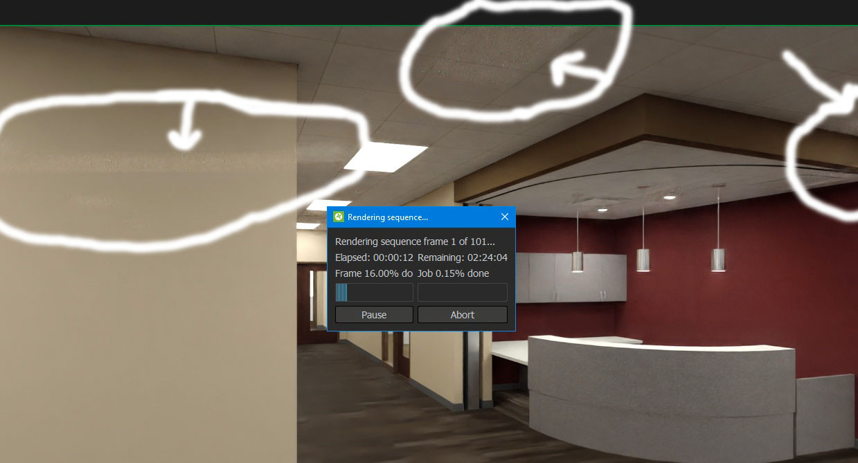

    i'll have to post settings a little later, but, sometimes when i start a high-quality render (no gi, reduce flickering, in this case 16 samples for lights - but previously with same but 8 samples per light - no bloom 250 or 300 or 400 samples, i get flashy what looks like lights or something.
    if i abort the first frame, then restart it, i do not get the flickering at all. so restarting the hq animation fixes it.
    it does not go away the more it renders the frame. oh, and it's more like the splotch pulses on/off as it's rendering. i have 1.8.1 or 1.8.2.
    thanks
    checked is: shading graph for glossy/GI. but those walls are not glossy or reflective at all.
