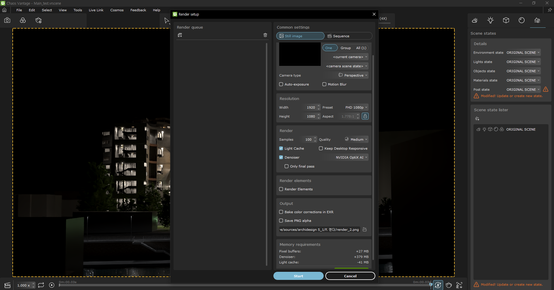

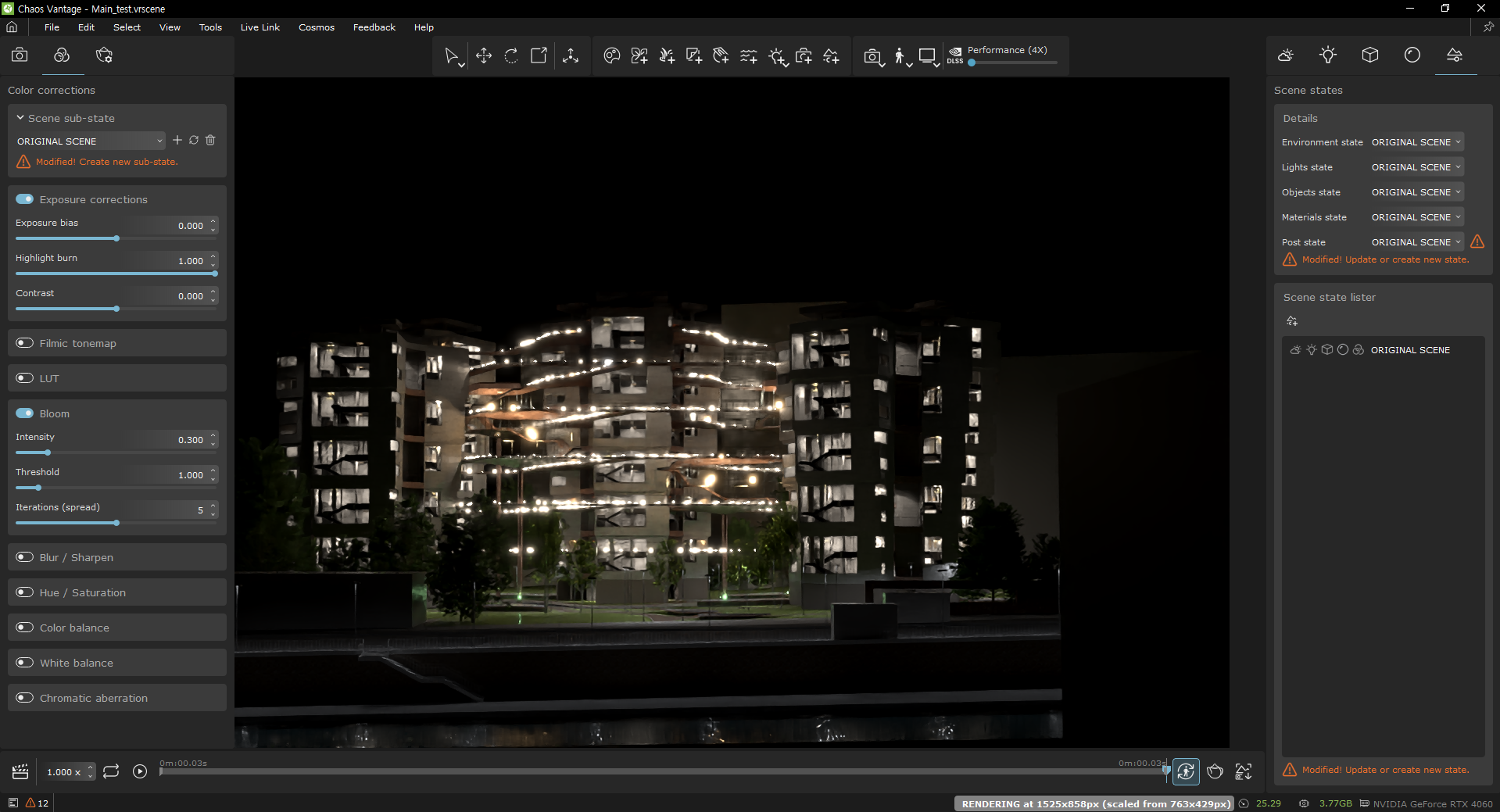

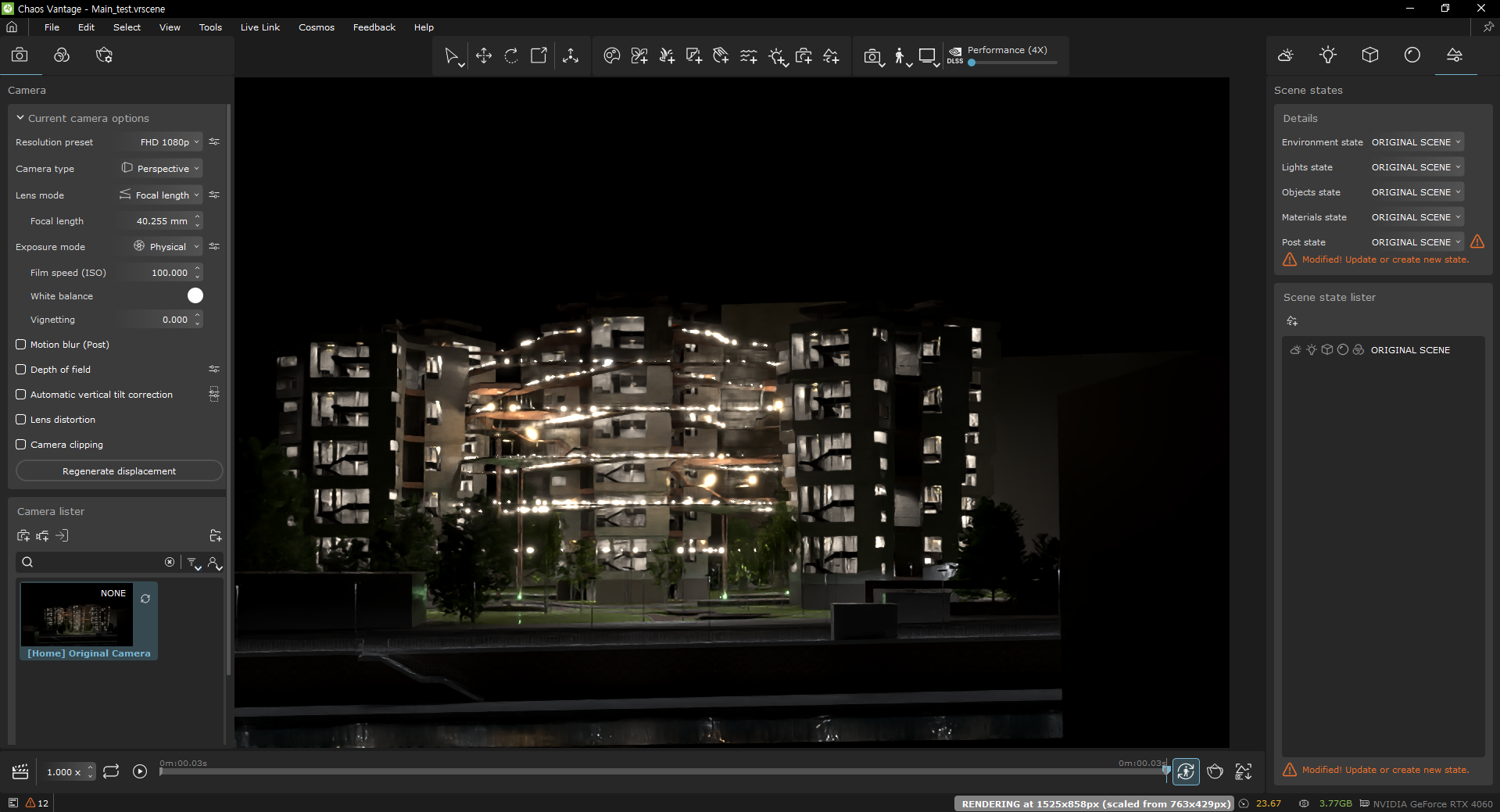

          and these are the settings of the render. (by the way, I couldn't find the AI-upscale box)

          It's the latest version of Chaos Vantage, and I use NVidia's RTX 4060.
          I've rendered it with both the Nvidia AI and the Vray Denoiser and two of them had the same blurry result.​

              In your screenshots upscaling is enabled for the interactive viewport - it's the "DLSS Performance" setting in the top toolbar. If you set it to 1X it will render at full resolution (slower, but cleaner). DLSS is only available in interactive mode. The offline Optix denoiser does not upscale.
              I suspect the main reason the image doesn't clean up is the Noise Threshold setting. Similar to V-Ray, this tells the renderer when to stop sampling a pixel. 0.1 is a very high value so it would stop sampling almost immediately. Try using the default value of 0.01 or less. If you set it to 0 every pixel will be sampled indefinitely until a fixed sample count limit is reached, such as the sample count you specify for offline rendering.
