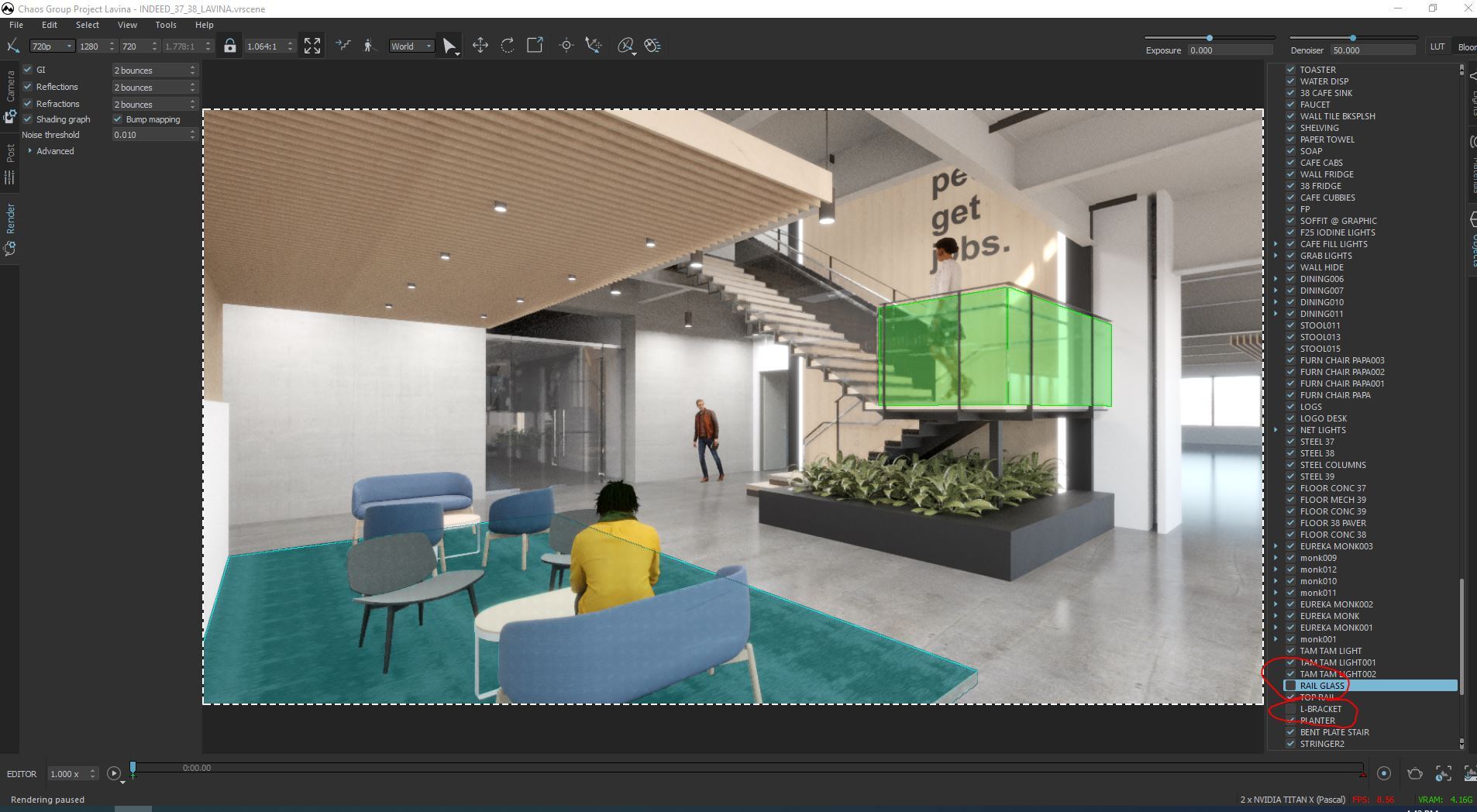

    Using Beta v .4.1 with 2X Titan X Pascal cards (not RTX).
    Getting a lot of flashing in any glass material so I started hiding glass as a work around for now... BUT, I'm finding that some objects don't hide when unchecked.
    At first I thought it was only happening with refractive objects, but found that some other objects are also not hiding.

      In prepping the scene to send to you, I think I found the root of the problem. In the first example, I had multiple objects with duplicate names in MAX. In Lavina, only 1 object hides/unhides as expected...the other objects with same name stay visible, regardless of checked/unchecked.
      Second file, uses unique names and hide/unhide works correctly.

          Thank you for the scene! Indeed, this is a bug in the UI. I will log a ticket and we should fix it soon.
          There is a partial workaround - when you select the object in the viewport you can click the "V" key to hide it (Shift+V to unhide). The problem is once you hide it if you change the selection you can no longer select it again by clicking on it in the viewport as it isn't there. That's where the object list comes in, if it wasn't for this bug. You could also save this selection with Ctrl+0...9 and restore with 0...9. You can find these viewport hotkeys in Help->Mouse and Key Shortcuts.

            Turns out the issue with duplicate names is at a deeper level than just the UI, so it may take a while to fix. If possible, use unique object names for the time being.
