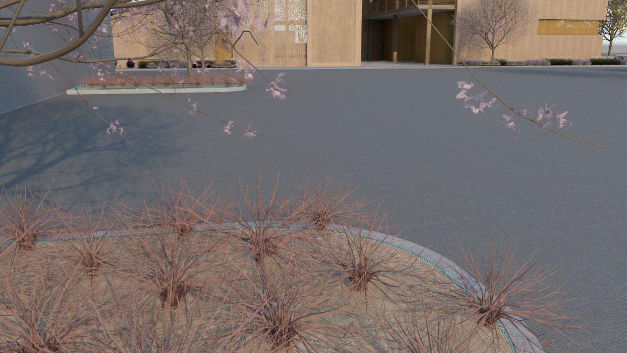

    Everything seems to export correctly to Lavina, but when I turn on the clipping for alpha map, most of the landscaping desapear. When I take a closer look I see that the alpha maps are applied but they are clipping the whole leaf or flower.

    Please take a look at the attaches images.

      Thank you, Vladimir. I did send you an email with part of the geometry.
      I explained also in the email, but to keep a record here, we use different Materials ID for multi textures to be able to adjust the size of each property, such specularity, reflection, bump, and so on. Sometimes is the same size but more often is not. You can see it in the file.
      regarding the alphas, I noticed if we use a Black and white texture for cut out, then Lavina works fine, but if you use an image with an embedded alpha, then it won't read that. For example, we have Laubwer trees, those use the same Tiff image for Diffuse and cut out, the Tif image has an alpha channel. in that case, Lavina won't cut out or will completely erase the leaf.
      Thank you for your help with this.

        So, there are two major issues as you described already:
        1. if a texture's alpha channel is used as an opacity map, results are incorrect. I've fixed this for our future builds.
        Note that we don't use the more complete "shading graph" system when sampling the opacity slot texture,
        as this calculation is very performance critical - it happens each time a ray intersects a triangle with an opacity map.
        If you have opacity map issues in the future, we can add them as more special cases, just like this alpha issue.
        2. Lavina supports only a single UV map. We will take a look at this, hopefully sometime soon.
