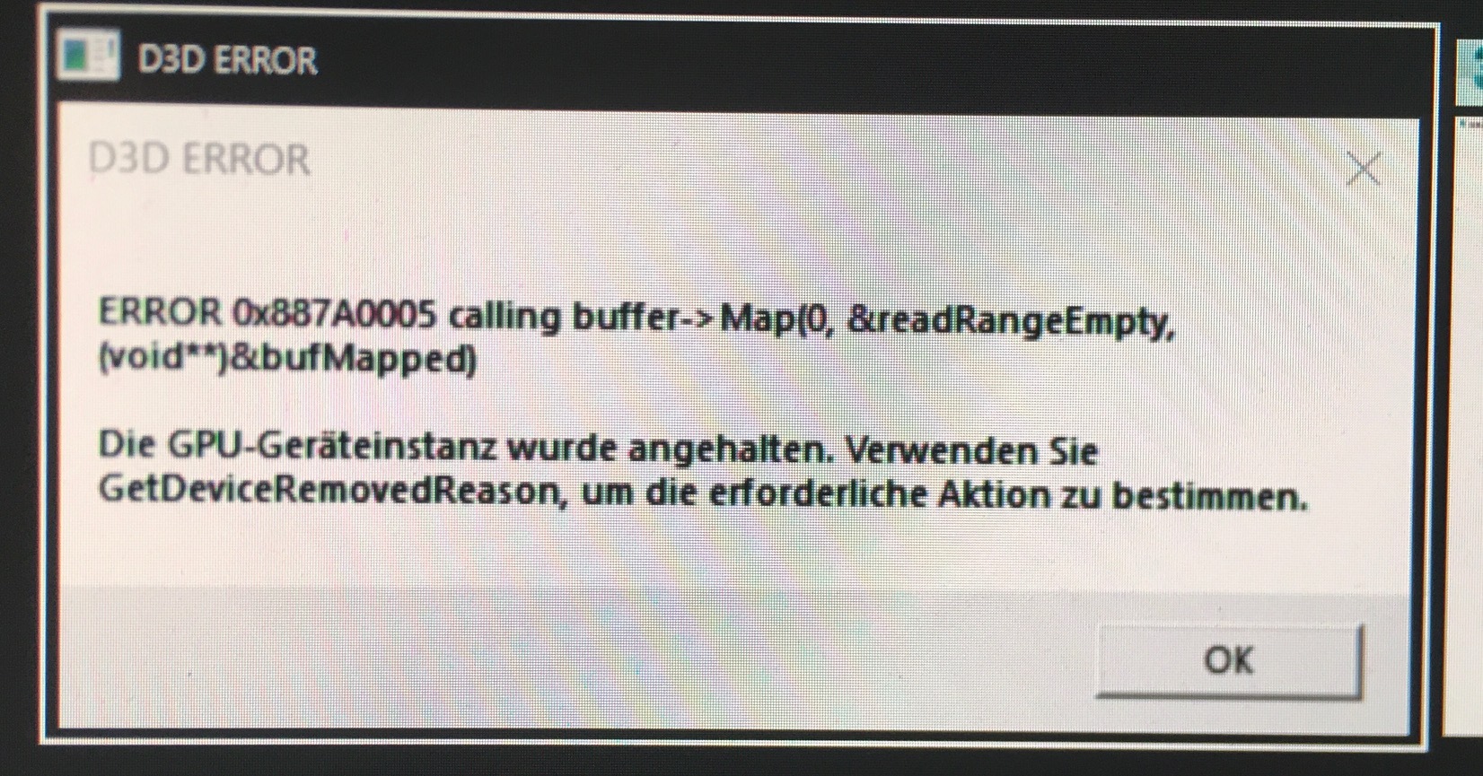

    Hello,
    bug report:
    I was loading a huge scene, and the GPU crashed and workstation needed to be started without chance to close applications.
    Attached a screenshot taken with smartphone.
    Using 2 x gtx1080 ti

    Click image for larger version  Name:	Vantage crash GPU IMG_3106.jpg Views:	0 Size:	525.8 KB ID:	1094365

      Thanks for the LiveLink page.
      The GPU options were already both enabled (I just installed it fresh and ran it as it was)

                              We need to improve memory usage with large resolutions.
                              There is quite a lot we could do there, but didn't have time for the release.
                              However, Vantage was designed to have the best interactivity possible, rendering large/print resolutions was never its goal.
                              V-Ray CPU/GPU will be better at this at least for some time.
                              Greetings,
                              Vladimir Nedev
