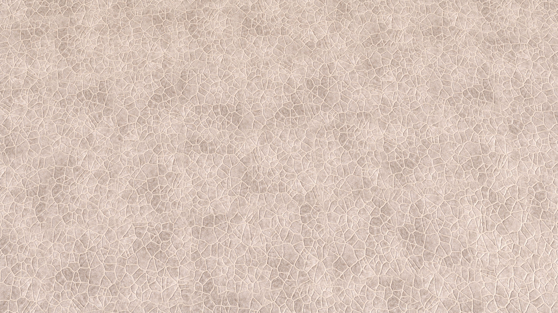

    Chaos Vantage is awesome but not usable for me at the moment because of a weird texture bug.
    I attached two images one from the default 3DS Max (V-Ray 5) rendering and one from Vantage. Maybe one of you knows what's the problem.
              I've recently seen this issue with the 46x.xx set of GPU drivers.
              They have some sort of bug in the compiler which messes our UVW calculations code.
              This can result in these stretched textures.
              We will most likely release a build with changes to our code that work around the nVidia driver bug.

                We released update 1.0.2 which includes a workaround for some of the 46x.xx series driver issues. It will warn about "unsupported driver", but you could ignore the warning and see if it renders correctly.
                This only applies if you guys were using the new drivers in the first place.
