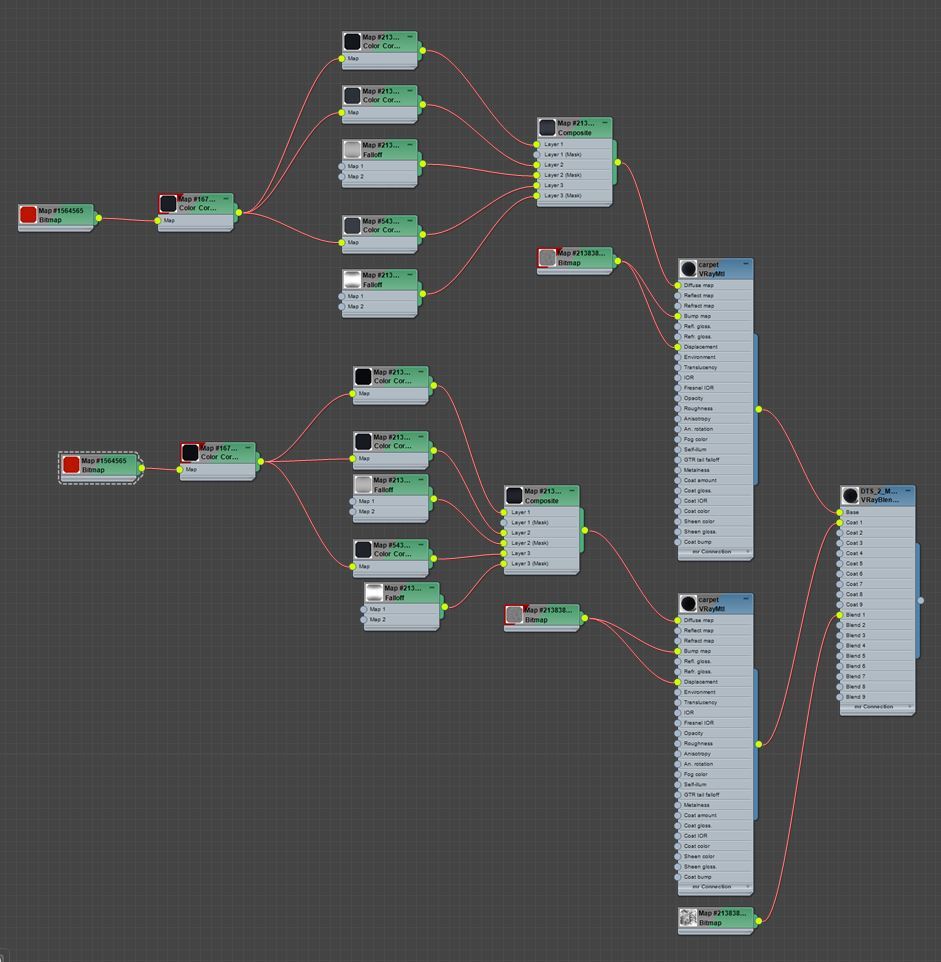

    I've been testing Vantage this week and notice that some textures don't carry through properly. See attached. One was rendered in max the other Vantage.

      Look at table base. The reflection is correct in the max version. The Vantage version is flat...almost like there is no reflection at all. Also the concrete floor. More reflection in Vantage, correct in Max.
        Could you upload a screenshot of the material graphs for the table and floor from 3dsMax, please?
        Also, are you using the denoiser in Vantage and is it the same without it?

          Like Nikola said, we need the scene or at least a screen-shot of the shading graphs to tell you what's unsupported in this case.
          Vantage does not support the full V-Ray feature set.
          I am guessing in your case you have a blend material which we don't support currently.

            I can send the file, but here are the mats the are rendering properly.

              Yes, it's the blend material and also the normal maps. We will be working on those in the future.
              However, before that we will implement the new coat layer in the V-Ray material. If you can use that, your scenes will be Vantage compatible sooner.

                I switch the coat on and no change in the material. Dull as ever. I had the live link and was hoping for some real-time update. I stopped live link and saved the file and opened it up in Vantage stand alone. No update.

                  The coat layer that Vlado mentioned is not in the released build and is under development. Same goes for the Blend material, Normal maps and VRayMuiltiSub Tex. There is no ETA for the moment but we will inform you when they become available.
