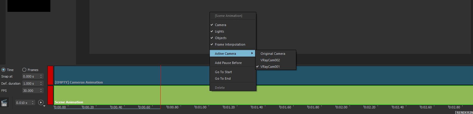

If you open the animation editor in Vantage, you can right click on the scene track to select the .vrscene camera to be used for animation playback.
See attached screen-shot.

Thanks for the prompt reply. Now I view all cameras.
