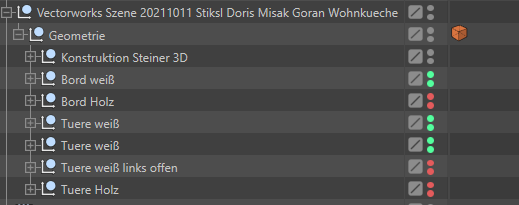

      1) I would like to select an object with one material and then select all objects with the same material and cover them with a different material at once!
      2) It would be great if the object groupings according to the JPG enclosed would be displayed by Cinema in Vantage right away.
      3) These two points would be very valuable for customer presentations so that I could assign geometries and colors for the drawings with one click.
      Thanks very much!
        You mean the object hierarchy ? I think this requires a change in the V-Ray for Cinema4D exporter.

          Yes, I mean I can't select several objects with the same material and assign a different color for customer presentations at once, now I have to select all objects individually and then I can cover them with a new material, which is very time-consuming and very cumbersome! Would be great if they could do something there and with the Hirachy too.
          Thanks very much!
