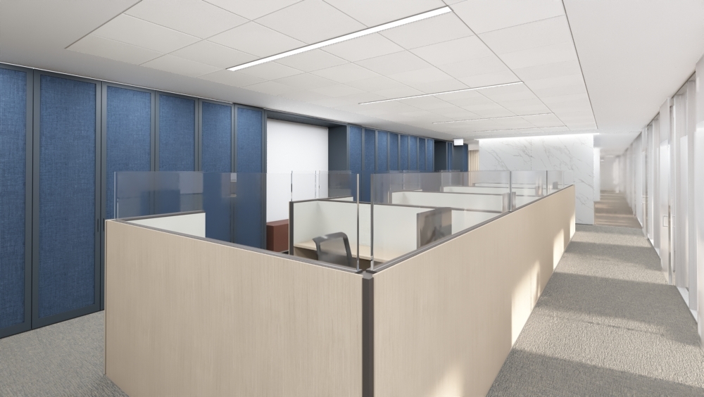

    I'm new to Vantage so forgive this question if the answer is obvious, when I send a scene to Vantage and it switches the render ending from CPU to GPU everything generally looks correct although it is usually a bit over exposed. When I switch the engine back to CPU and render my scene it's overexposed and looks totally different. The attached images are an example of this, all I did was export the Vantage scene and then switch the render engine from GPU to CPU.

      No the Vray GPU result is overexposed and saturated while the Vantage image is very close to what the CPU engine renders.
      Ok so apparently switching from CPU to GPU changes my color mapping settings from Exponential to Reinhard so that explains why it looks so different. Why does it do that?
