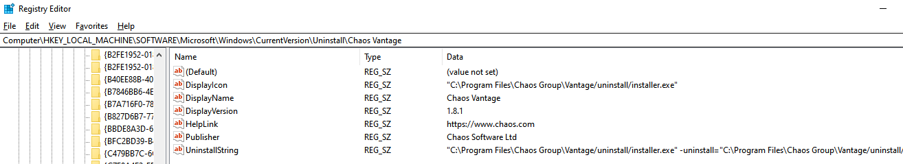

              Could you please check if this location exists in your Windows registry and looks similar?

                Yes it is exactly the same.
                  Well, I have no idea why it wouldn't work then. V-Ray will only skip creating the Vantage toolbar if the registry key is missing (meaning Vantage is not installed).
