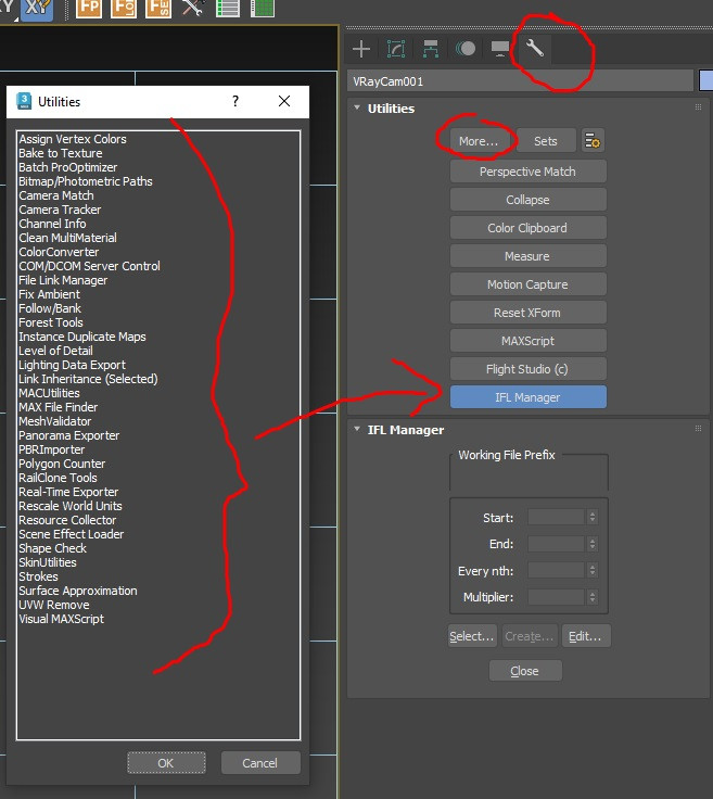

    Hi, thanks for posting. Using a gif for animated texture is not ideal. A better approach is to export the video or gif to single images and use them trough the IFL Manager in 3ds Max to load a sequence. This way you will have better control on your frame rate and also Vantage supports it.
