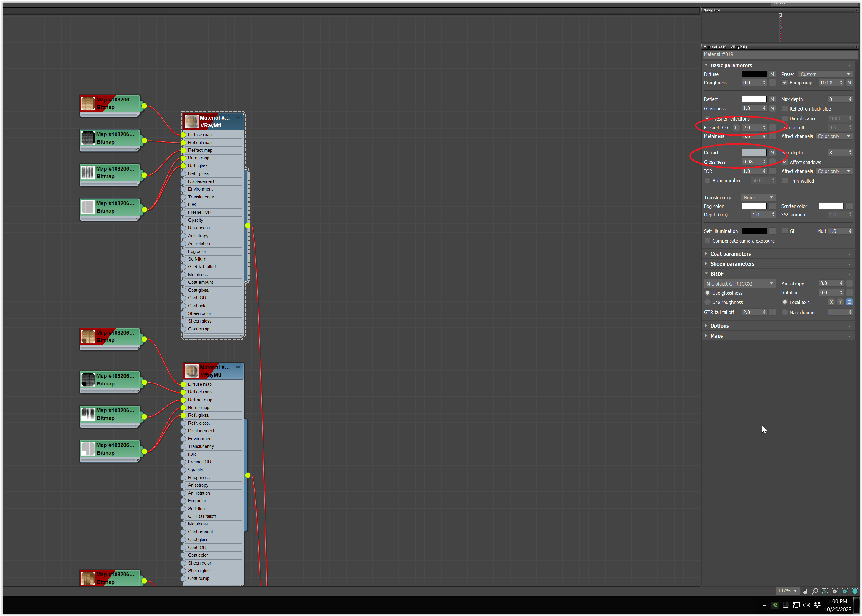

          I think I might found the culprit here but still this doesn't solve the problem totally, because in 1.8.6 it worked well, even with this values.
          I have attached screenshots with names and you can take a look at'em.

            Refraction glossiness was skipped prior to 2.1 so now the refraction glossiness will actually render and make a difference. And since Use for refraction/mirror reflections is used only for pure (meaning 1.0 in value, anything below is glossy) reflections and with 2.1 refractions - it will use the environment map and not the background one. So this is not a bug, this is how it currently works until we improve the Use for refraction/mirror reflections ​option to work with glossy refractions/reflections(LAV-1650). Does the render match the 1.8.6 version with refraction glossiness set to 1?

              Indeed the render match the 1.8.6 version with refraction glossiness set to 1 and the refraction color to be set to 0 0 0 (black).
              The only issue right now is that I have to rework a ton of MTLs because they have this 0,98 value instead of 1.
              But still the function needs to be improved, because how it currently works using only the environment map and not the background one, can cause lots of headaches, at least in my case...
