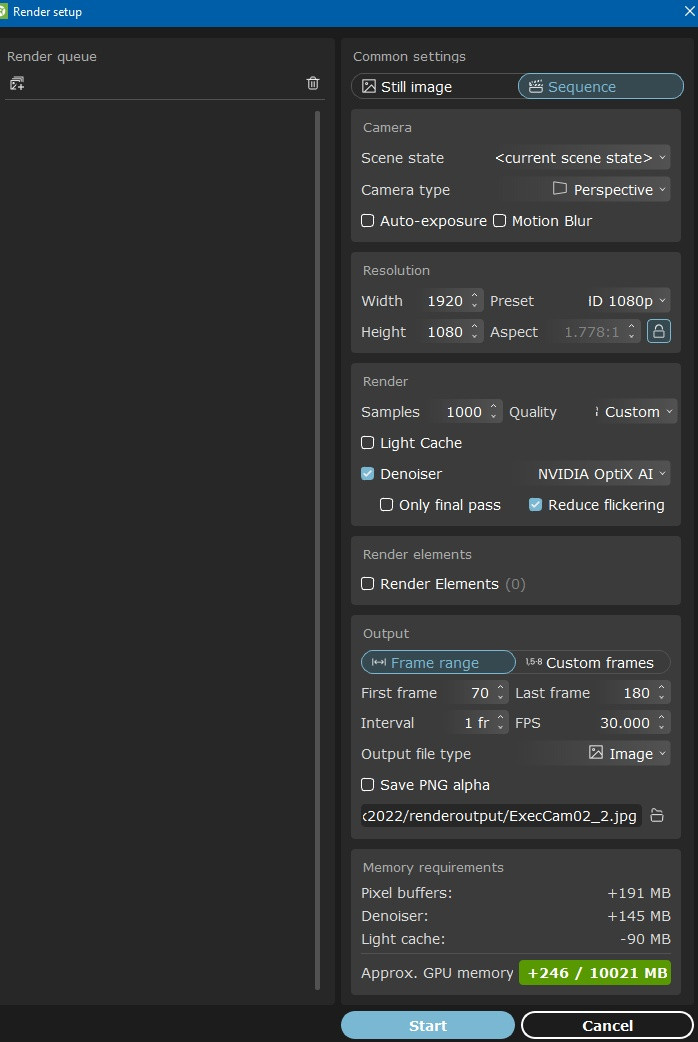

    latest version of Vantage installed yesterday, video drivers on 2 4080 cards is: 546.01. i either get horizontal lines, or smooth walls are blotchy. the whole scene has daylight and many lights from 3ds max scene, but the animation is just 1 room/office. i have dynamic textures disabled (that seemed to help this morning, but not since) i'll attach my settings.

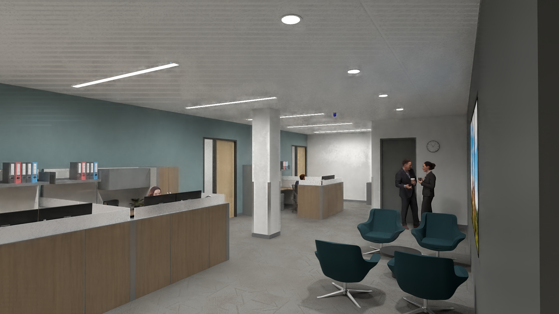

    here's some examples
      these lines are showing up also
        i just changed my render devices from 2 cards automatic, to 1 card. i had to re-start the live link but so far it's rendering a lot cleaner and of course double the time. i've just tried 1 card vs. 2 cards 3 times now, and each time i have automatic selected or, manually choose one or two cards, i get poor quality renders on 2 cards and better quality renders on 1 card only.

              I don't think it's related to the denoiser. Such lines point to an issue with the multi-gpu render. The difference in quality is probably because Light Cache is not supported in multi-gpu mode.

                i can't grab a screen shot of what it looks like when the vantage viewport updates, but it initally starts with a ton of lines (maybe its in one of my examples?) with 2 GPU's. 1 GPU is a lot better.
                also i do have Lightcache disabled (that was one of the first things i tried).
                i am also seeing this reflection or highlight just below this linear light. and this is only with 1 GPU. so i'm investigating my materials and model and light to see if i can get rid of it. it moves right-to-left and starts out short, then grows, then shrinks back down. i have similar "flares" with can lights in the scene.

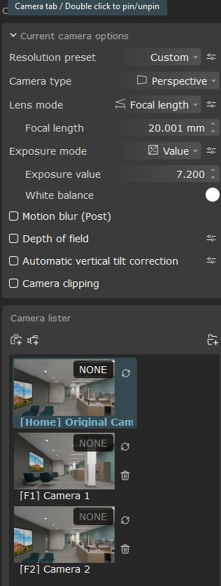

                      here's what i have.

                          so this is no light-cache, no moblur, 1 GPU. anyway to get rid of these? the vray light is in the can but a few inches. the can has a small ring around it which proud of the ceiling which has a normal map. or could this be related to the issues somehow? denoise is non-legacy nvidia. i showed previous image which affected the linear lights and those seem to be minimized now, but this has become a bit more prominent on the can lights.
                          Click image for larger version  Name:	image.png Views:	0 Size:	110.9 KB ID:	1204485
