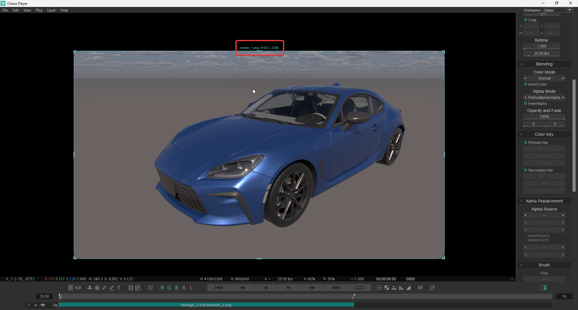

    This is one simple scene (cosmos model) that I rendered with 4100x2306 resolution and 350 samples. I am using RTX4070 and Vantage 2.5.
