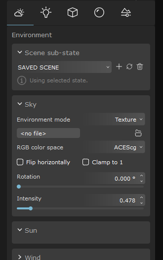

    Hi,
    Im having lots of issues with vantage.
    1. Is it normal when i click live link, that the middle upper toolbar in vantage becomes very limited? the only buttons available are camera,navigation,render settings and dlss. All the rest are gone.Like the move, rotate, cosmo etc
    2. Suddenly I have no access to the sky and the sun?​ Sun is empty and when I want to choose sky, there is no option for it. only texture.
    If there is already a Sun in the host application then the Sun properties inside Vantage disappear. If there is no Sun in the host then there will be settings for it in Vantage.
