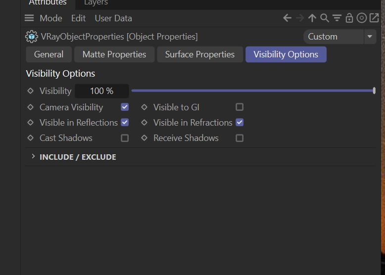

          Hi Zhanet,
          I meant that if I have a scene with a background that I want to disable the shadows it casts, this doesn't work. On vray work fine but on Vantage didn't work
          I use Cinema 4d 2024.5.1 with vray 6 update 2.3 and Vantage 2.5.2
            Hi visualtracing__​, if you don't want to cast shadows in Vantage, avoid using a dome light or sky in your scene. Instead, use the Background option in Vantage.
              Hi Zhanet,,
              i'm work on live link and on interior scene is my priority work with dome light.
                I understand the need for a dome light or sky. You can submit this as a feature request on our Ideas Portal.
