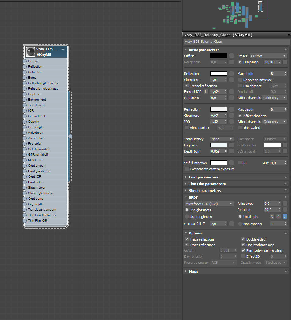

    Hello,
    I have a glass material (please see the attached settings), and during Live Link, models viewed through the refraction appear to be missing textures. However, once I change the Refraction Glossiness to 1, everything looks correct (as shown in the third screenshot).

      You have to enable "shading graph for glossy/GI".

        Many thanks!
