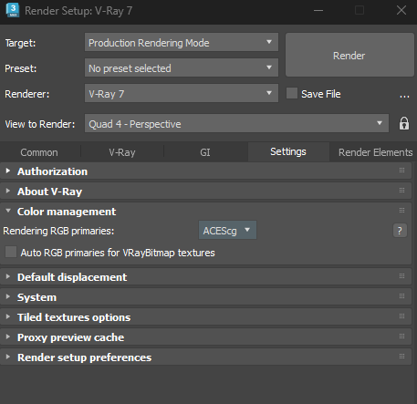

        Also note that when you turn off OCIO after creating a scene with it enabled by default, there is a setting in the V-Ray render options that you need to change as well.
        This has to be set to sRGB to completely turn off the OCIO workflow.

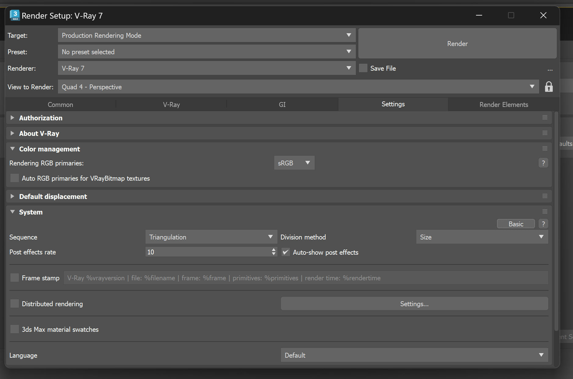

          So let me know if this the correct setup combo with MAX and Vray.
            The color management mode should be set to "gamma workflow" I believe, i.e. the behavior before OCIO became the default in 3dsMax.
