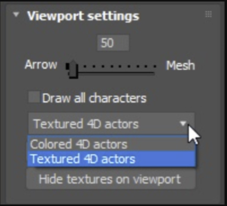

    You can optimise the performance by using these options:
    Coloured 4D actors = yellow on viewport and animated texture in render
    Textured 4D actors = animated texture everywhere
    If you experience freezing we will have to investigate this further.
