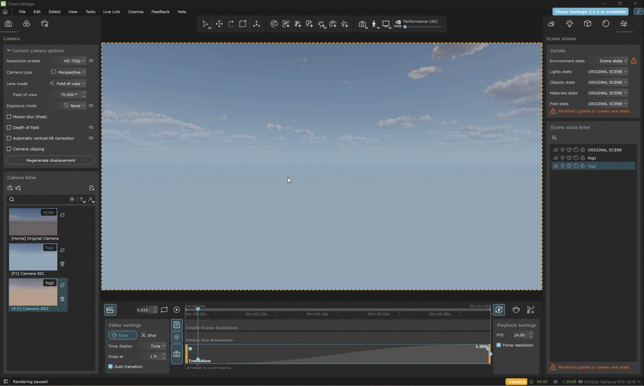

    Hi, thanks for posting.
    You could animate the simple fog using scene states.
    If you enable the fog scattering checker then the fog is affected by the Sun's altitude.
