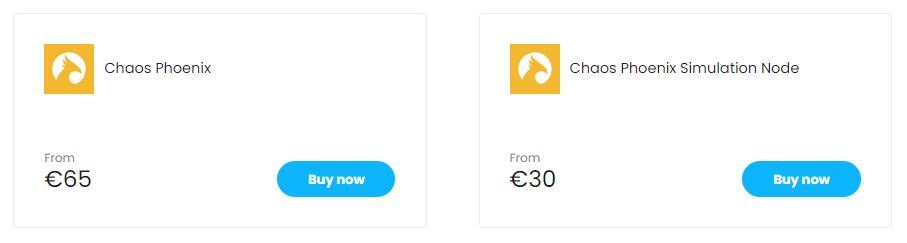

    Hello,
    I've look around a bit and didn't find my answer,
    I was wondering if there is any render node for Phoenix FD to buy.
    I was able to find a way to buy new Phoenix FD licence, new Phoenix FD simulation node, but any Phoenix FD render node.
    Is a Phoenix FD simulation node = Phoenix FD render node
    Is there any other solution than buy a new Phoenix FD licence for a render node,
    Is there maybe an option to render a Phoenix FD setup without a licence (via Deadline / backburner etc.)

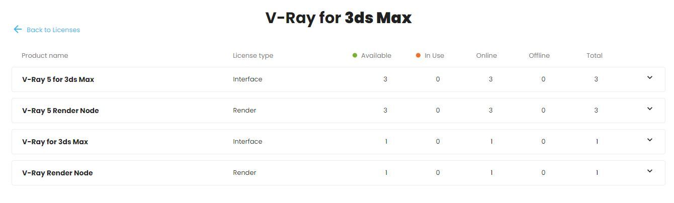

          Vray (52002) is installed on all of our machines (6 computers for 4 licences)
          Phoenix FD (44100) is installed on all of our machines (6 computers for 1 licence)
          Distributed licencing via "my chaos" work perfectly for everything, we use the licences tab to check who use what, we dont use the other tab "licence server".
          If I get everything right, I should be able to render 4 different projects on 4 differents computers with my setup, and everyone of those 4 projects with Phoenix FD simulation in it.
          At this moment we dont use Deadline or Backburner yet. We only render projects by hand by opening 3DSMAX project, and running the render (image sequences most of the time).
          But we can only render a single project with Phoenix FD simulation in it, other 3 project will render perfectly but without any Phoenix FD sim in it.
