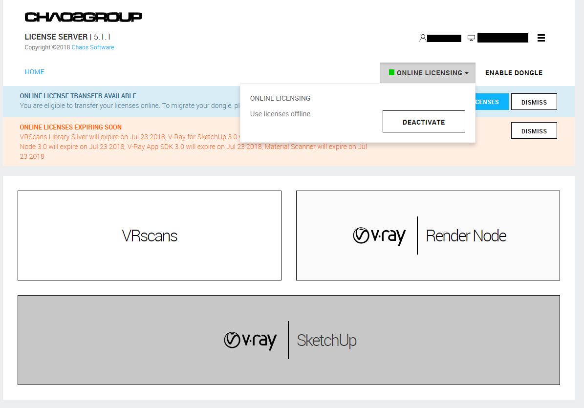

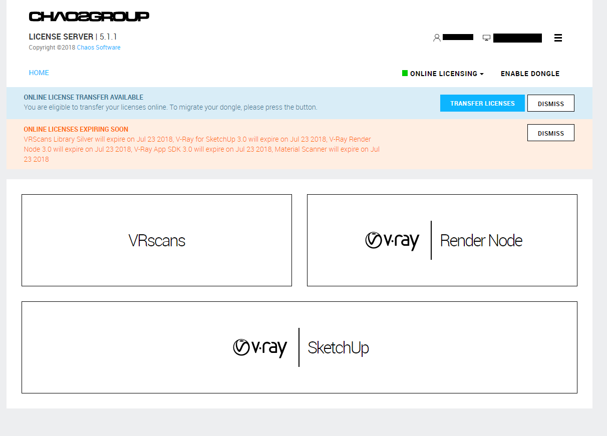

            Great!!
            Now I am able to access the http://localhost:30304 but the license information is incorrect. The License Server Page says my online license will finish soon while I just purchased it (it should be Non-expiring license). Please see attached.
              Hello,
              It is possible that the expiration message is related to a V-Ray Trial license that you have previously applied.
              Please send us these screenshots including the information about the username that you are currently logged in to support@chaosgroup.com in order to provide you with more specific information regarding your licenses.
