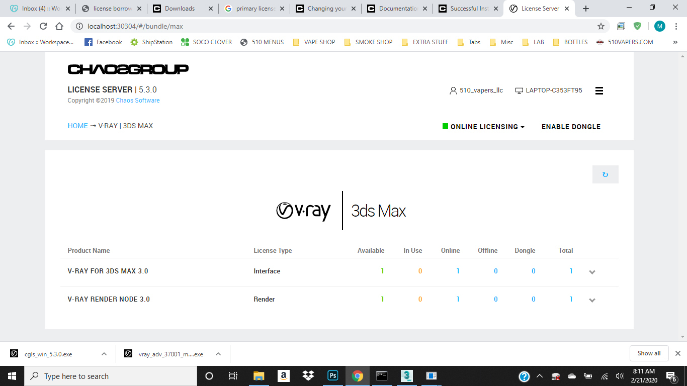

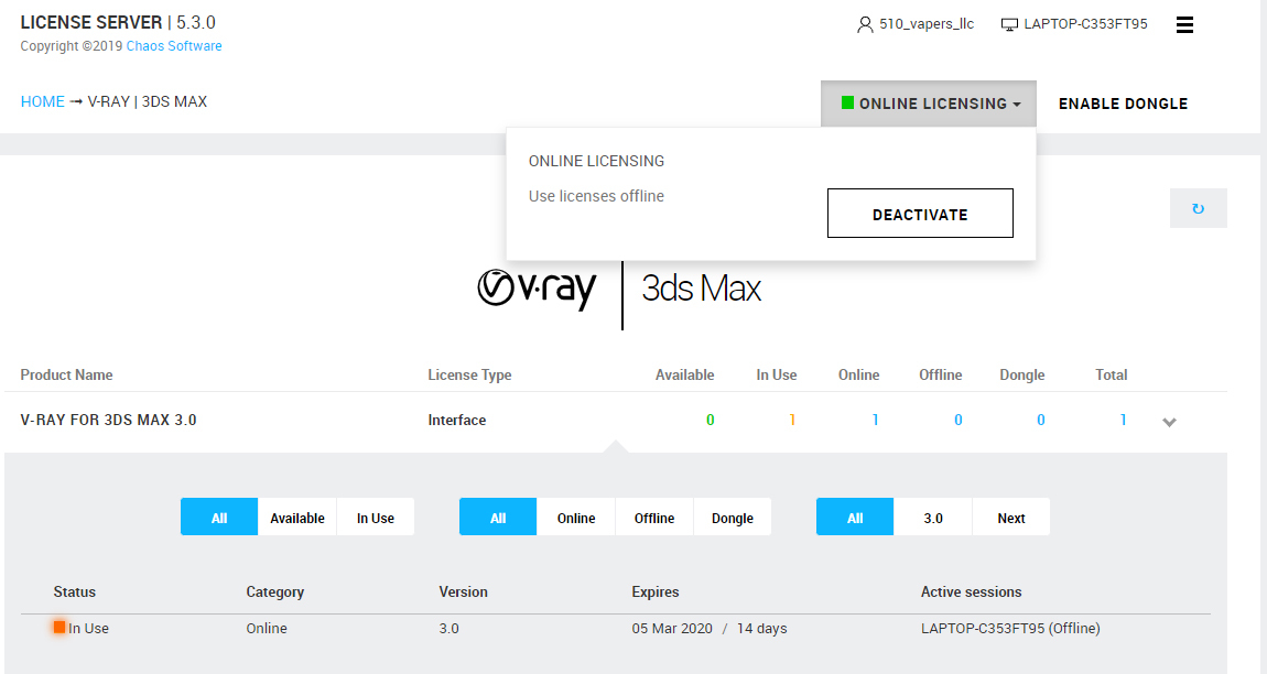

                      I am having a similar problem right now. I had enabled the borrowed license for my new laptop because I could not get it to get a license online.
                      The online seems to be working now but I cannot release the borrowed license now. I have read the docs and posts about how to do this, but it doesn't work. It shows the laptop as the machine that has the borrowed licenses, but there is no release option on it.
                        Try deleting the browser cache, the license seems correctly released on the backend.
                        If you still have issues, however - please message us at support@chaosgroup.com and we will look into it.

                        • #13
                          Thanks ! I have it sorted.
