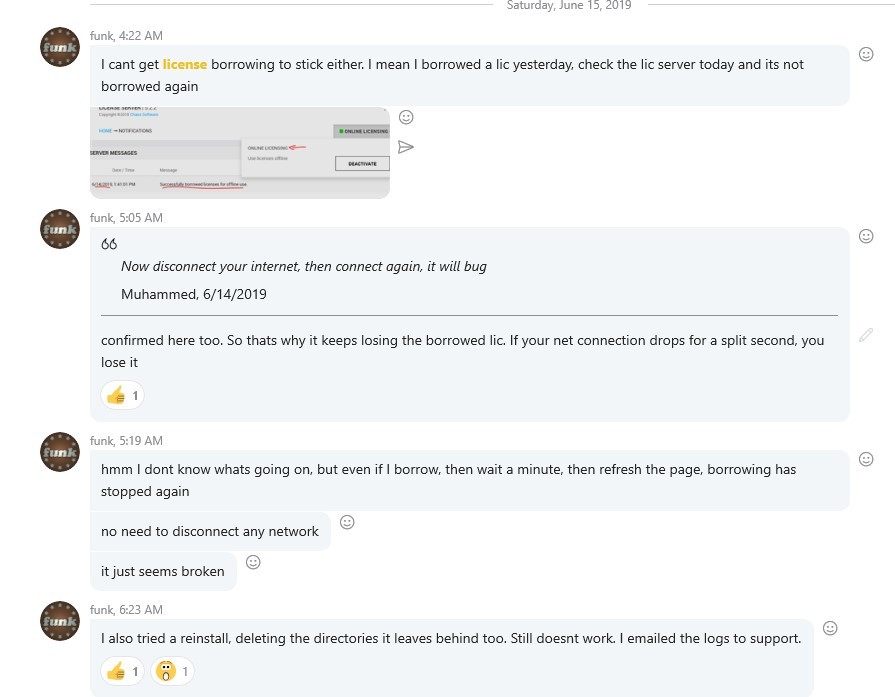

      borrow your offline licenses >> disconnect your Wifi or network cable >> Open Max and do a test render, it should render fine
      Now connect your Wifi/cable , then disconnect >> Now try to render in Max, you will get licensing errors
      I tried this on few machines, I never got offline licensing to work with 5.2.2
      Let me know if this worked for you
      This also explains why your offline licenses didn't work yesterday during the outage
      I checked and it works. But yesterday support changed the proxy settings from none to http proxy, so I guess that is what one has to do to make it work in general? dont know anything about the details.

          I've tried on several machines, I've never been able to get it to work with 5.2.2
          Last time I checked was last week,
          Funk contacted support and they used team viewer and installed 5.1.2 on his machine, for offline licensing to work
          Oleg_Budeanu You have 5.2.2 installed?
          You can check here
          http://localhost:30304/#/
          MANUEL_MOUSIOL Can you confirm you are on 5.2.2?
          I will try again today, and Will send them an Email
          I've got other Modo users to try as well, they have the same issue..

            Maybe try disconnecting your internet few times, it will eventually give you an error..
