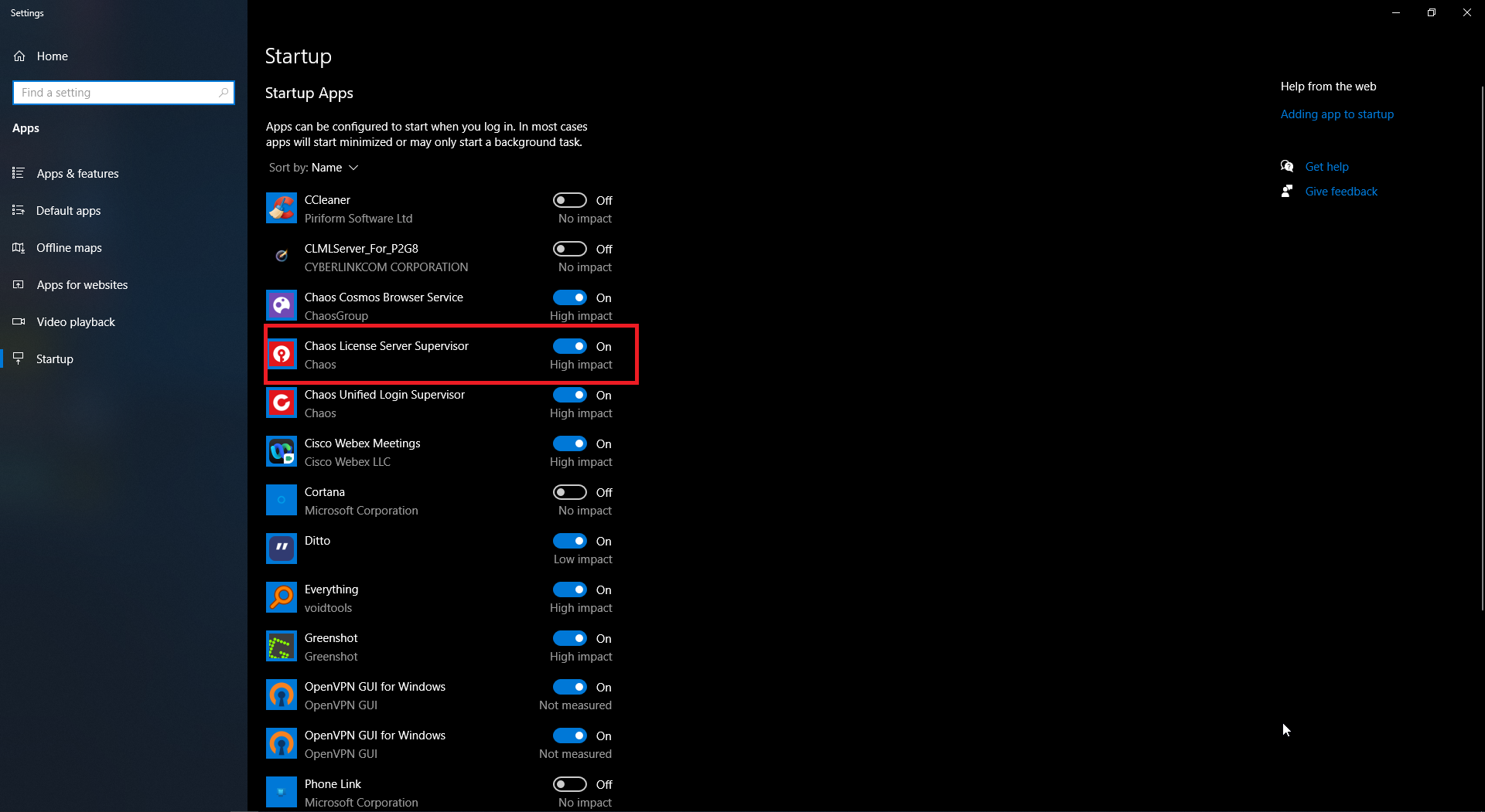

    No you don't, make sure the Chaos license server is running. Open in a browser http://localhost:30304, if the page doesn't load click on the Windows Start button, type Start Chaos license server and press enter. Try the http://localhost:30304 page again, it should load and you should see the licenses listed there. You will be able to use them now. Also check in Windows's Startup Apps if the Chaos License Server Supervisor is enabled otherwise the license server will not start automatically after restart.
