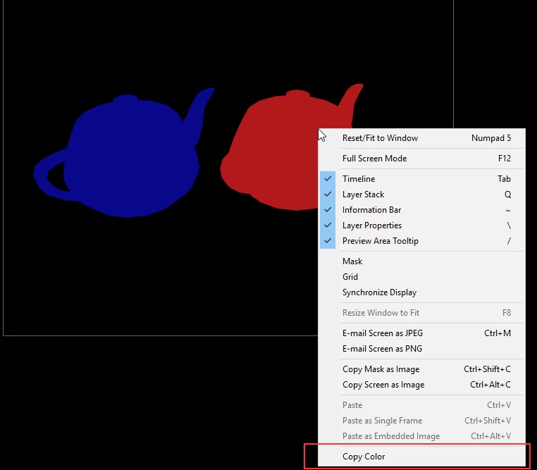

    1.Copy the wireframe color:

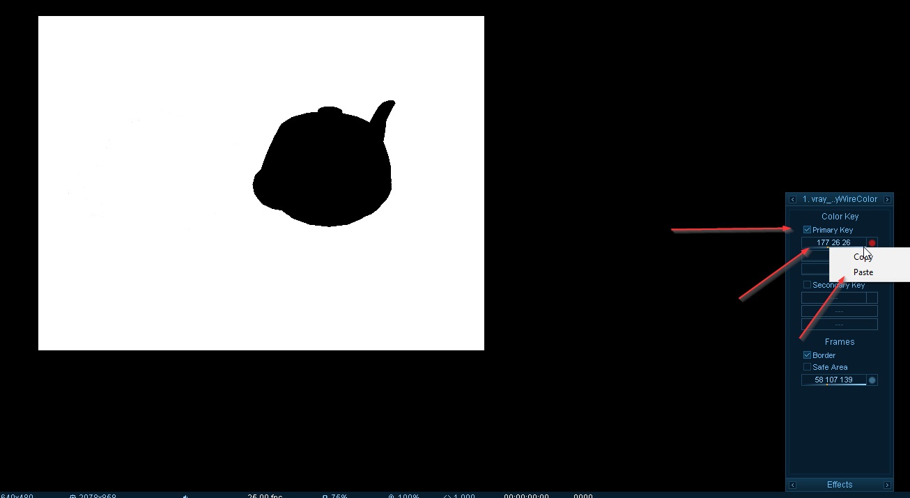

    2.From the Color Key option activate Primary Key and paste the color in the color slot:
    The press A to show the alpha channel and tweak the parameter bellow the color slider to fine tweak the mask.
