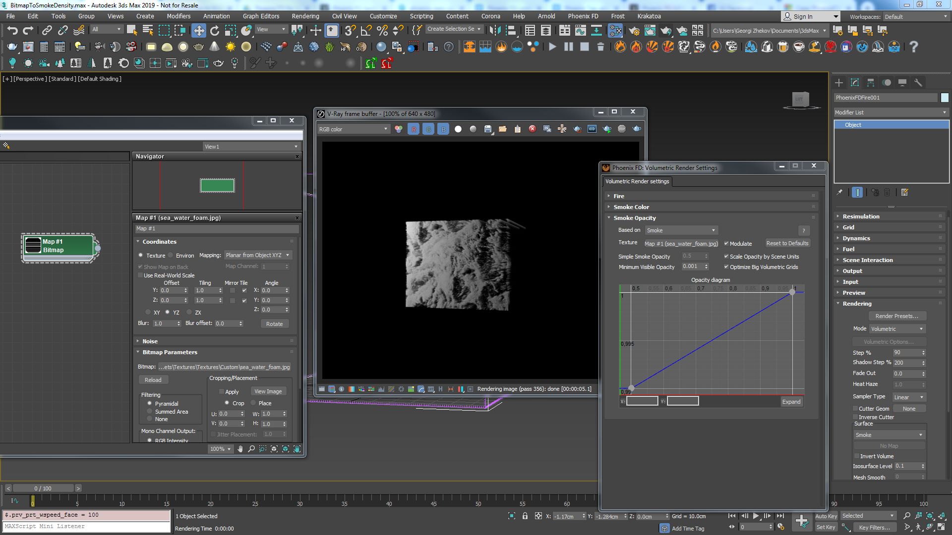

    How one can do that ? Like heightfield, without the need to create geo and fill with smoke.

    You can create an empty grid, set the Smoke opacity to be based on Smoke and shift the leftmost curve point so its value is something more than 0. Then just assign the texture and it should be working without the need of simulation.

      Hm, you sure ?

        Yes, check this post here - https://www.facebook.com/groups/VRay...6402350512336/
        It works even with Volume Grid on GPU, in the comments there is a video with the full setup.

          Well, bitmap is not like 3d noise. If you can prove me wrong - would be great!
          What I need
          map 0-1 from bitmap to Z grid values fitted f.e. to 0-0.05, and resulting volume should be filled with 1
          If it can be created via scripted processing - that's fine too. Just show plz some example.

            As the texture is 2D and the Phoenix Volume is 3d you will need to change the mapping for the bitmap. Set it to Planar from Object XYZ and then pick the right axis.

              Excuse me, but do you find that projection anyhow useful ?
              So, to be straight - there's no way of making what I'm after ?
              Originally posted by Paul Oblomov View Post
              What I need

                Only at render time this is not possible yet. You can try and experiment with a distance texture multiplied by your bitmap, probably that could work for your case?
