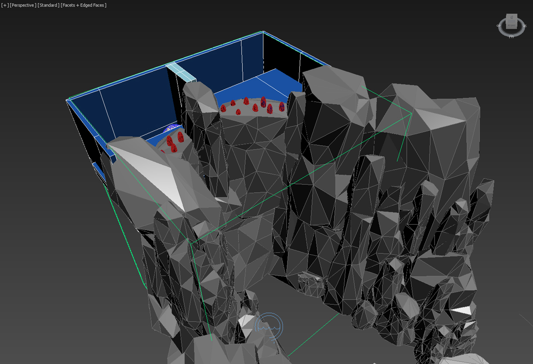

    Here's a screengrab of my scene file (rocks in the final sim will be more detailed). The fluid emitters, one box for each side of the waterfall, are underneath the blue ledges, I thought doing this would allow the fluid to rise up within the blue container and settle to become less turbulent by the time it reaches the lip of the waterfall.

    Currently only using 1 grid although I've done some simple cascade tests to get familiar with that feature incase it's a better solution.
    Grid size is non adaptive, 50 x 52.5 x 75m, scene scale is 1 and cell size is 25cm, giving 12.6M cells. I used the default waterfall preset for the initial setup and most settings are still at their default values.
    Does this seem like a reasonable starting point, in terms of grid and cell size, etc?

    The waterfall preset settings and your setup indeed are a good starting point.
    Indeed looping and play speed change at the same time are not implemented currently. You would have to simulate at the final frame rate. You also need to make sure you have particle IDs and Ages exported for each and every particle system in the Output rollout, so looping would work correctly.
