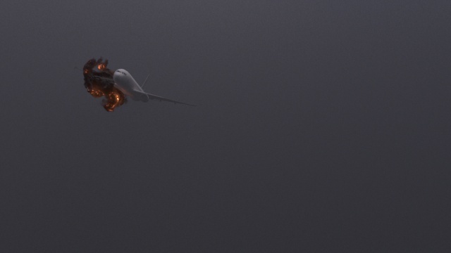

                              First of all I didn't know you are a part of the team that invented Phoenix. My bad I am new to it. I just want to tell you it's absolutely revolutionary and made for artists. Stuff you creat in Phoenix in 3 hours would take a month in Houdini so thank you for that. Secondly part of my frustration IS the fact that I see it being used in the best way possible but I am struggling to get that photorealistic look. I think the secret is also at in understanding that fire/smoke shader that I don't really get. My smoke is always set to 1 and that's the thicknes value otherwise looks think and I feel like it's overdone but I just can't get it right to save my life. Now closes I've come is this render I am working on currently. It's an airplane falling of the sky with engine on fire. Due to the moving airplane and moving camera I had to end up having voxel heavy scene because it keeps expanding as airplane keeps falling. No biggei. It should last about 300 frames. So what I think I can do is simulate with really high QUALITY setting of like 100 and plus. And then RESIMULATE to add detail. Now that I am doing that I am ggetting somewhere. Also I am sorry but I keep changing my settings every minut to try to see if it betters the outome so I can't really share any real settings as they keep changing.
                              One thing I noticed is that I feel like my PhoenixFD smoke doesn't rect to VRay Volumetrics and fog in the scene. Or I might be wrong and not see correctly. Phoenix is really responosive to anything in the scene soo I am sure there would be no reason to be included in VrayVolumetric environment.
