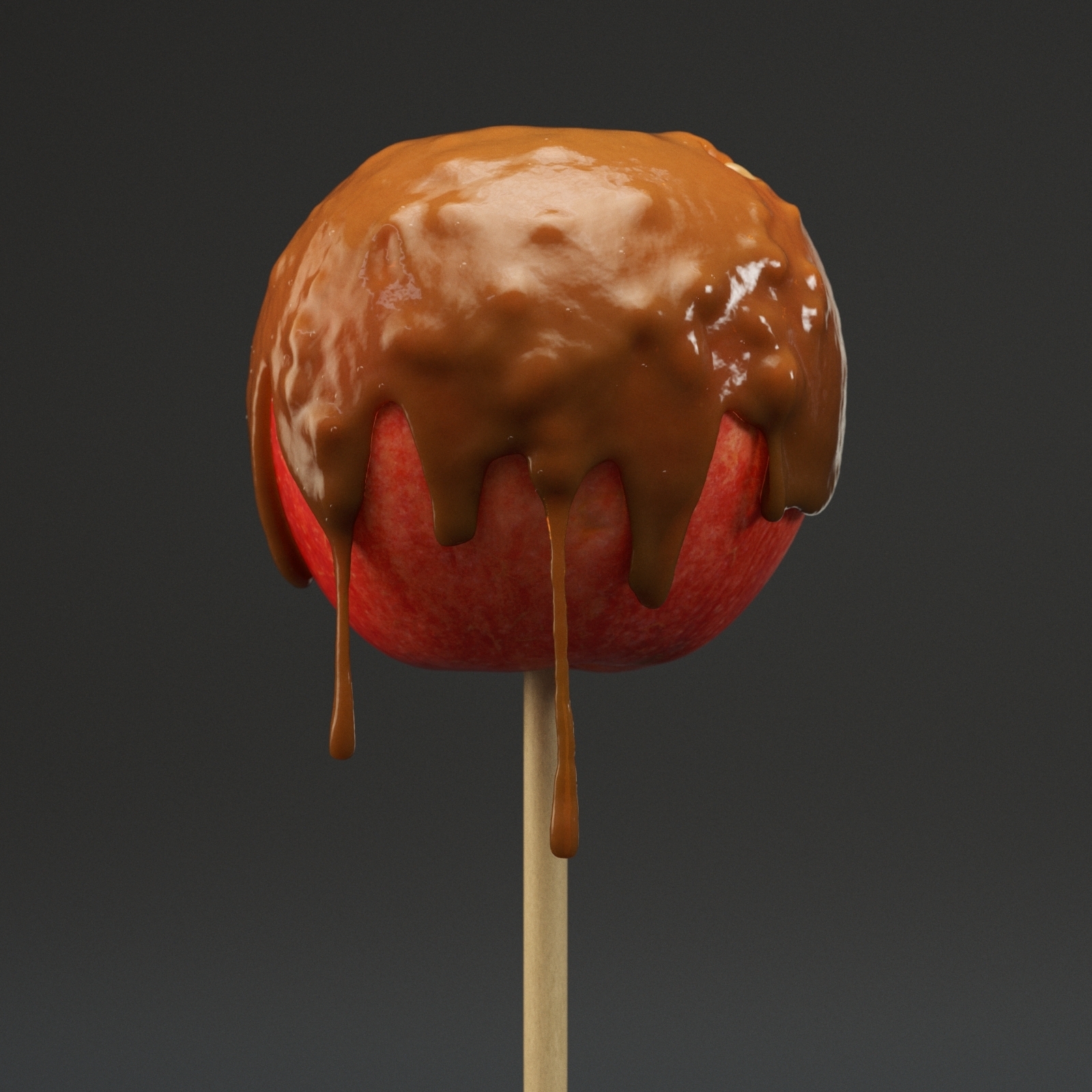

    Back in the PHX forums for some guidance. I am using the attached settings for a caramel material and particle shader. The biggest hurdle I am having is trying to see how to adjust the air bubbles so they look more random in size and not as perfect circles. Maybe someone has used the shader and can shed some light on how to adjust these. Super welcome to any additional feedback people may have. Just trying to further my knowledge with this great plug-in.

    If you're using Foam particles for the bubbles you can adjust the Variation Small, Variation Large and the Size distribution in the Foam rollout.
    If you're using the Liquid particles with reduced Count multiplier in the Particle Shader in 3ds Max you can use pFlow or tyFlow to create some particles (with different size) based on the liquid and then render them with the Particle Shader.
    If you're using the Liquid particles in Maya - I'm afraid that there is no way to randomize the size yet, but we have some ideas on how to do that in the future. So it's best to use the Foam particles in this case.

      Ah, the particle shader renders spheres in the Bubbles/Splashes/Cellular modes and this is how it must be in order to be able to render tons of particles quickly.
      Instead, maybe you could use the V-Ray instancer and instance irregular shapes over the particles though? Not sure how you could reduce the number of particles that way though - maybe you are using Count Multiplier on the liquid particles? If this is the case, an alternative to using reduced liquid particles would be use pflow or tyflow and use a fluid force operator to drive pflow or tyflow particles with the liquid, and then instance your animated irregular shape using V-Ray instancer over that?
