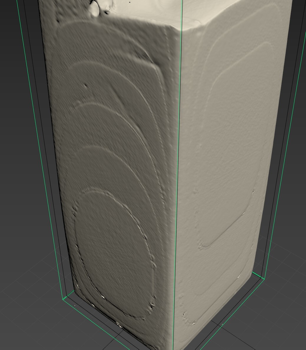

      This is good idea and will try that! Now my emitter is gradually pushing more particles and then slowing down at some point so it might be bit tricky to calculate second basis. But that initial fill/container idea is good since it gives me some idea of how much I need particles. So I can compare particle amounts in tests I already made. I´m also having a bit problem with my container wall interactions, I get some kind of weird artefacts to the liquid where it should be totally smooth. Noticed that adding thickness of the container wall (shell modifier) makes this less noticable but still got some areas where I have some weird thing happening. Thanks for fast reply!
      Here is a screenshot of the artefacts:

        The render cutter should help in such cases. Just pick the container as a cutter in the Rendering rollout of the simulator and turn on the Invert Cutter checkbox. You can find more about the cutters here - https://docs.chaosgroup.com/display/...ing-Parameters
        You might want to check if the Isosurface render mode looks. By default, the mode is set to Mesh which may produce artifacts in the rendered image.

          Ill try that as soon as I get to rendering stage, is this something I can change after simulation? So no need to resimulate everything again? Thanks!
            Yes, it's a render time effect, so no need to simulate again.
