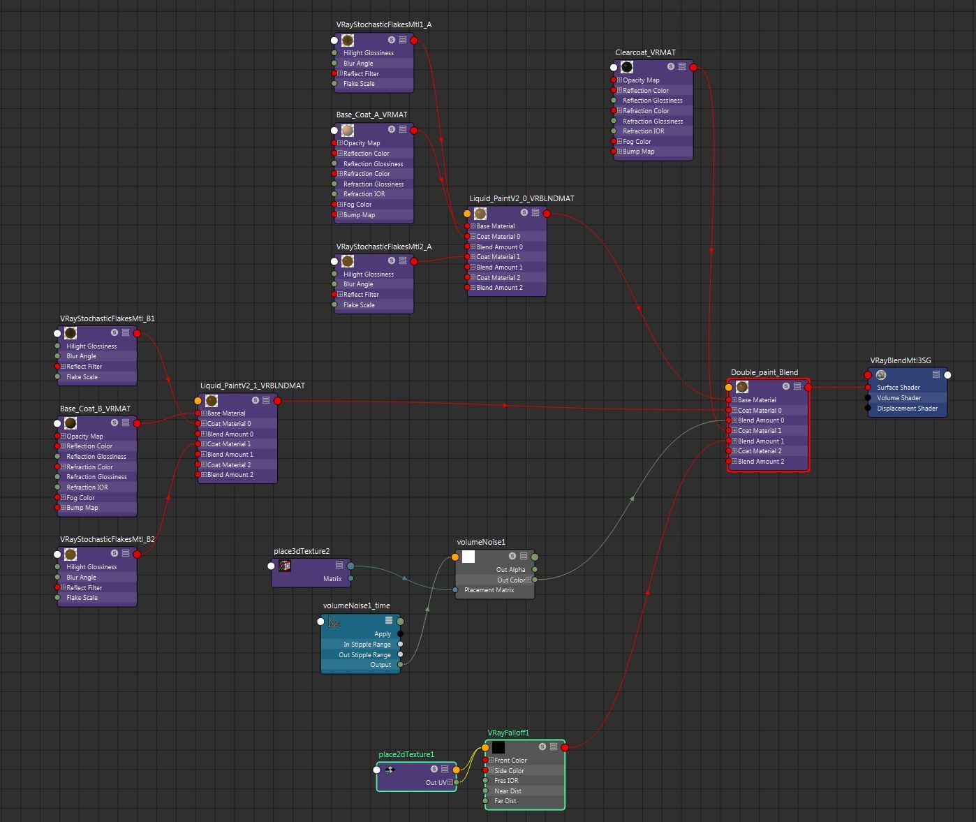

my main problem is i haven't figured out where the PhoenixFDtexture would slot in to this material setup to try and simulate it and get the flakes to flow and interact with the liquid.

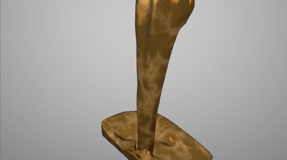

(pic of current progress)
(current shader setup)
How could i fix my shader to incorporate the flakes in to the pour and flow? Have i even gone about this the right way?
Short clip of current Progress
