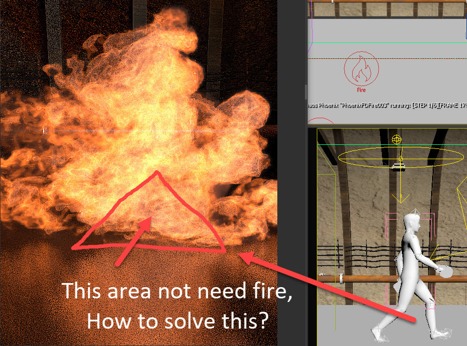

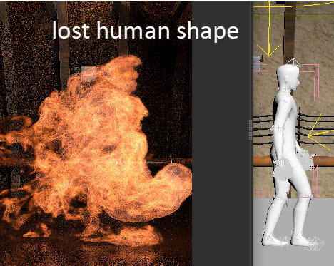

    Hello, I want create a walking fire man effect, but after some days and much tests, the fire man looks can't keep human's shape in walking.
    I have adjusted much parameters, but no luck with the result. How to let it keep the human's shape? Thanks.
    Want keep the human's shape, any help?

          Hi,
          I have adjusted the parameters, but still can't keep the animation shape.
          Where is the problem?
            Hey, could it be that you have some additional forces in the scene - may be they are too strong? Looks like fire is blown too strong to the side?
            Is it possible to share the scene so we can check what is going on?

              Hi, georgi.zhekov
              Yes there only has a wind with 20 strength

                  Thanks for the file. Soo your Motion Velocity in the Phoenix source is set to 6 - this will push the fire a lot so dial it back to 1.
                  Your Wind is a bit strong as well - you can either turn it off or lower the strength.
                  Since you're using adaptive grid you might need to add some Extra margin so that the grid can keep expanding.

                    There 1 foot always disappear, how to has fire on it?
                    I have add outgoing velocity and Energy, decrease the cooling, but still can't get it appear.
                      In the scene you have sent, when I lowered the motion velocity to 1 both feet have fire. In the screenshot looks like your grid resolution is a bit low, does it get better if you lower the motion velocity to 1 and increase the grid resolution a bit?
