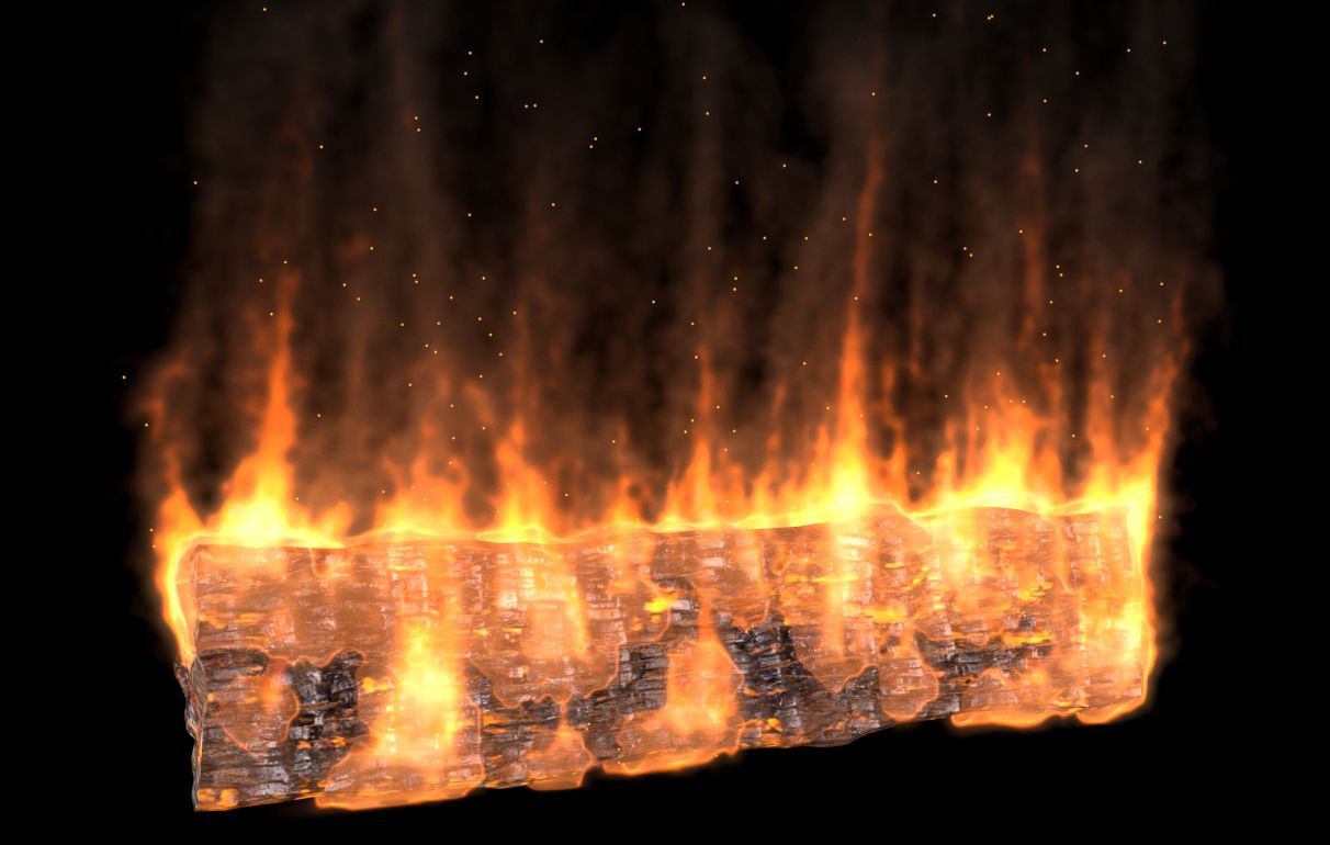

    I'll admit I'm still learning a lot about Phoenix but have done a lot of tutorials and spent about 100 hours with it. I can't find any info on how to sharpen the flames. They are always a bit blurry. I'll attach what I'm working on and I'll also a client reference. He keeps saying, "make your flames sharper like the reference photo."
    I'm having trouble achieving this. Any hints?

    Hey, sounds like this is the effect you are looking for: http://phoenixfd.blogspot.com/2019/0...re-trails.html
    Have you tried this tutorial?
      Svetlin, this might be exactly what I needed. I neglected to look at the Blog site in my search for help. I really appreciate it and will try it right away. Thank you...

          Svetlin, it was EXACTLY what I needed. Now my flame looks like a fireplace and not a gasoline fire. Thank you again.
