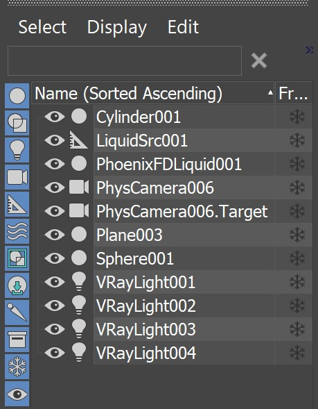

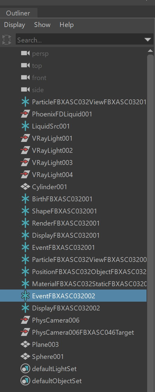

      Hi slavina.nikolova, Thank you for your response. When I try that function, only 3 objects transfer over, the rest are locators and empty groups. Below is the outlier from Max and Maya after Send to Maya as New Scene is used.

        Yes, the idea of Send to is to transfer the geometries, but currently you need to create all Phoenix objects.
