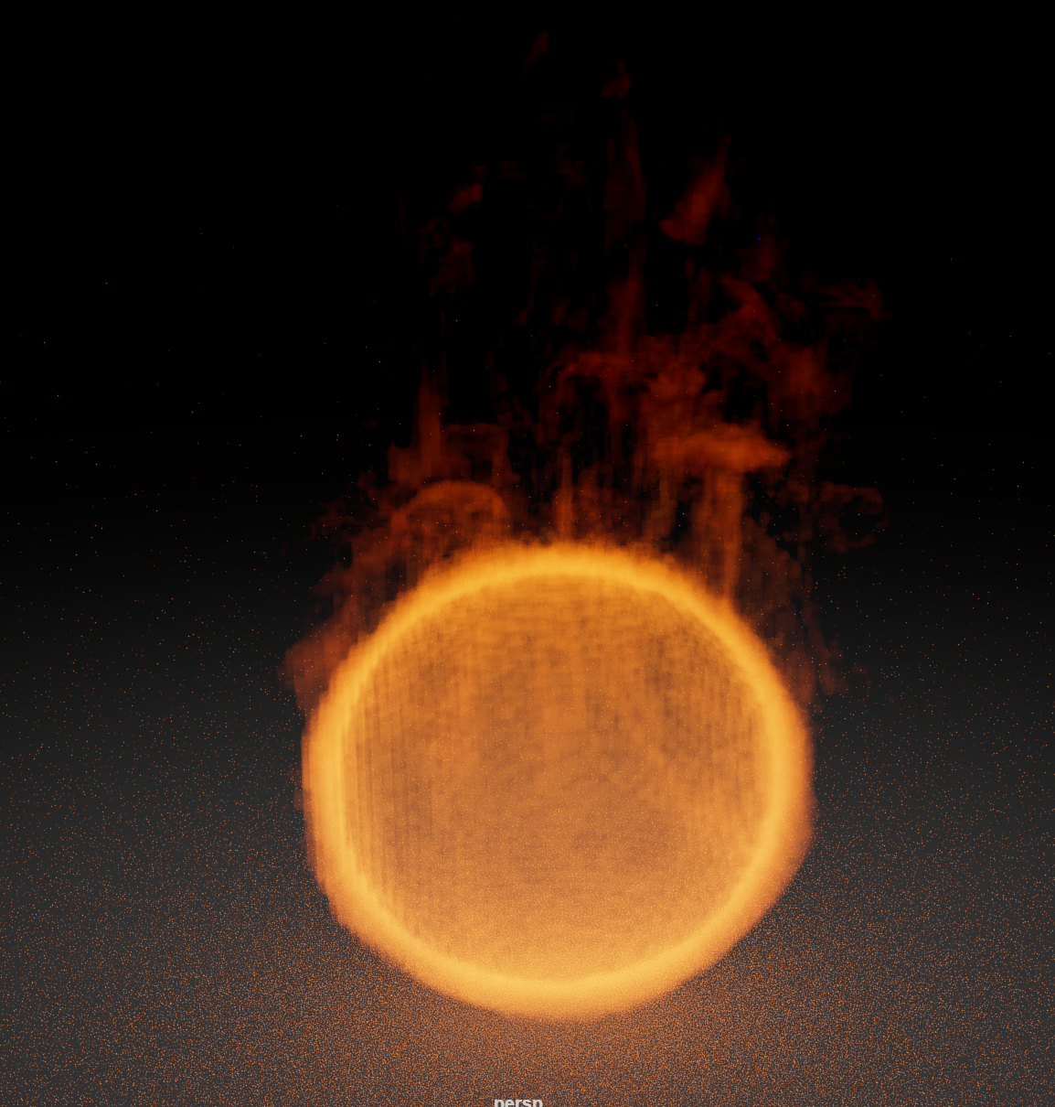

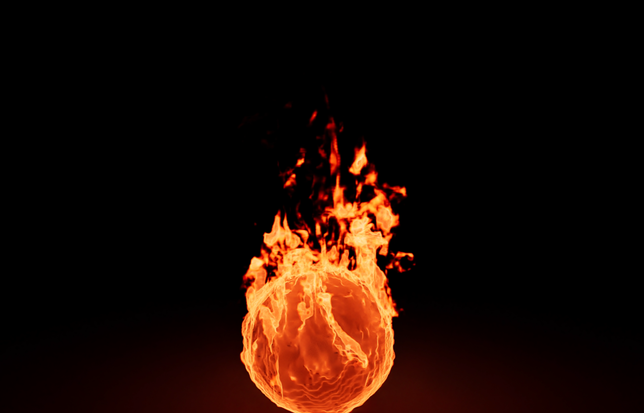

          Svetlin.Nikolov georgi.zhekov , how can i render basic a fire sim with Arnold. I followed the same steps for smoke and just replaced smoke_phx with Tempurature_phx and got close but it still isnt quite right. Are there any other steps that are different in the Chaos video tutorial on rending the explosion sim but just fire instead? Arnold is still lacking the detail in the fire.
          see my comparison below
          rendered in vray

          rendered in Arnold

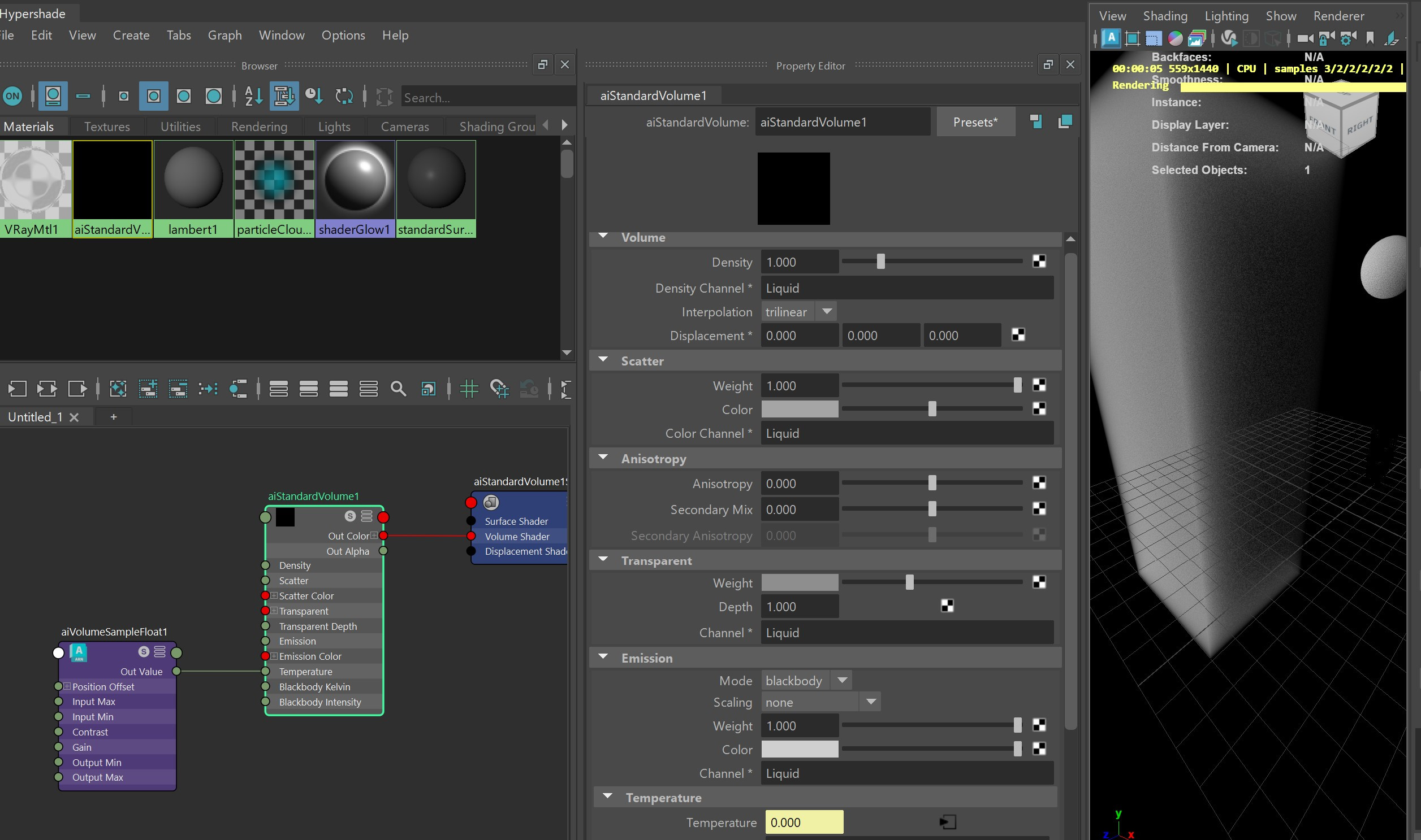

            It's all about playing with the settings in the Arnold shader. You can adjust the Blackbody intensity and the Blackbody contrast values in order to produce a similar result.
            Georgi Zhekov
            Phoenix Product Manager
            Chaos
              I did adjust those settings they look nothing alike.

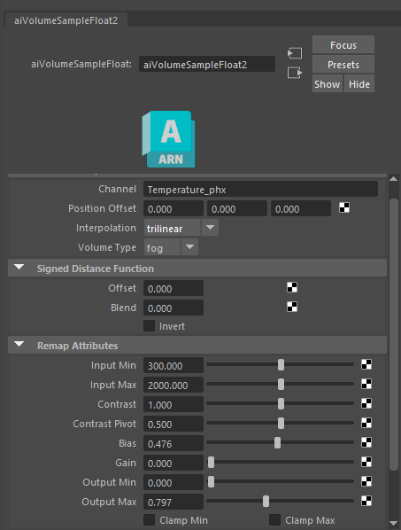

                Since Arnold and V-Ray have a bit different controls and ways of doing things, not sure you can get the exact same result, but here is my take on it without being an Arnold expert.
                Attaching the results I got and the settings I used. It's not in the screenshot, but the density in the aiStandardVolume shader is set to 0 so that only the temperature is shaded.

                    Here it is. The output settings look good, maybe it's something else.
                    The Phoenix nodes are hidden, you can unhide them, run the sim, then load the caches in the aiVolume node and it should work.
