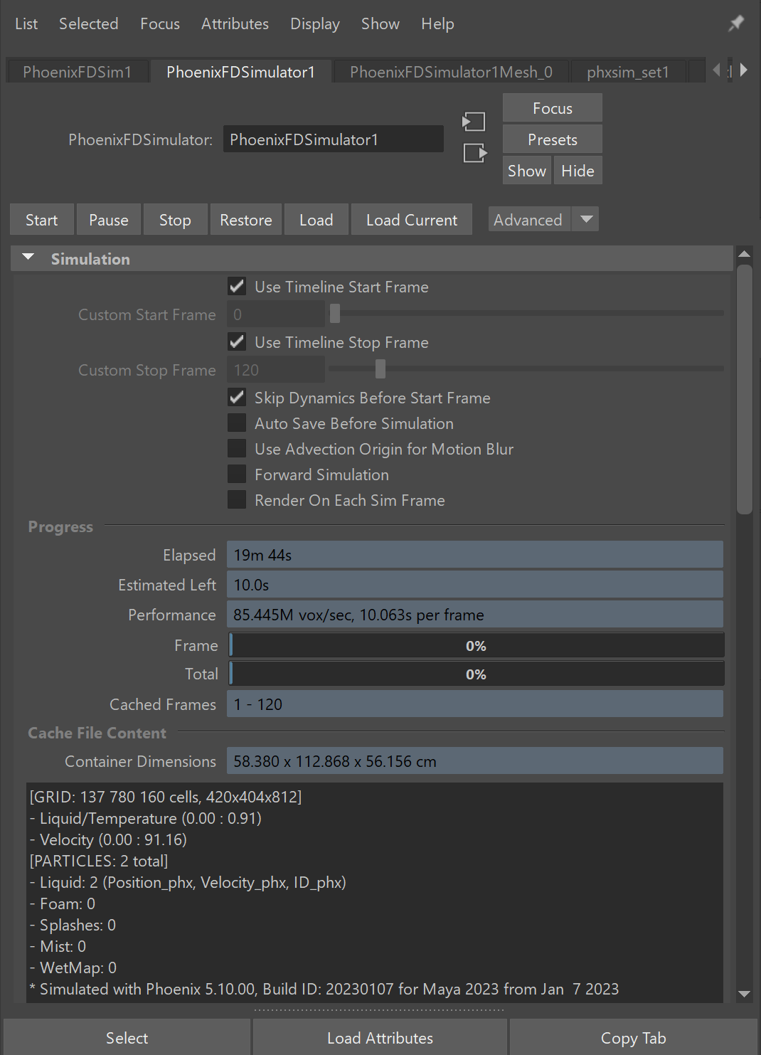

      Hi @georgi.zhekov
      Attached are my settings and here is a link to a 4 second render. Im just emitting from a cube with low discharge. I enabled splash like you suggesting but didnt effect the water colliding. only from where its emitting.

          Oh yes, you need to enable Wetting under the Liquid rollout and there you have the Sticky Liquids option that would help you.
          Also, for small scale liquid simulations, it would be good to have at least some Surface Tension, so you could try raising this a little as well.

            I tried turning on Wetting and adding .1 surface tension but still couldnt produce splashing after droplets collide with the floor. See my renders bellow. I have also linked to my scene file if you could kindly adjust my settings to create dropplet splashes. When i enable splash/mist, it comes from the emitter, not on the collision.

              Oh, definitely try making your droplets larger - if they are made up of just one liquid particle, then they can't split and create a splash ring when the droplet hits.

                      Also a couple notes on your scene - definitely reduce the Simulator size and shrink it only around the two planes - the simulation is running super slowly because the simulator is huge.
                      Also, in order to lower the simulation times, set the Step Per Frame in the Liquid rollout to 1 and raise them only if you really need to - raising the Steps per Frame is needed if the fluid is moving very fast or if there are obstacles or sources in the scene that are moving very fast. With liquids, you could raise the Steps Per Frame to make them smoother or if you want to get a better viscosity effect. Since you don't have viscosity in this setup, raise the Steps per Frame only if the liquid gets dotted, disjointed and rough.
