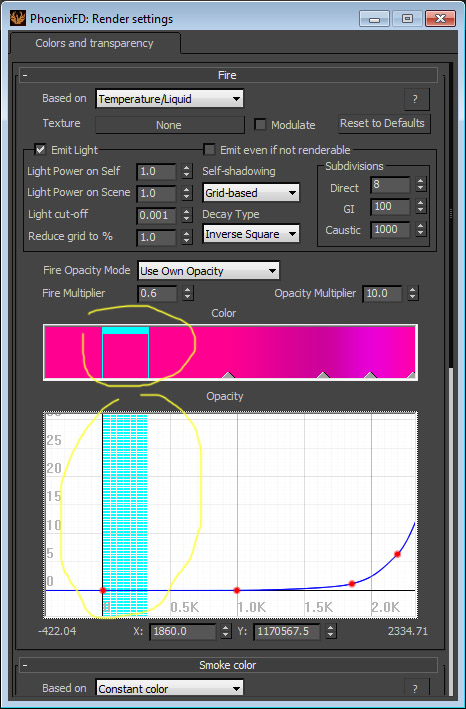

    What does the blue area represent on the Colour and Opacity graphs in the render dialogue?
    what you mean, i can't see blue area
    ______________________________________________
    VRScans developer
      the area circled in yellow - is it the range of the current simulation?
        Yup, it's the range of the channel chosen for the fire in the current frame.
        Looks like you've got a cold flame? (below 300 Kelvin)
          very handy to know
          yeah it's cold - first frame of the sim
