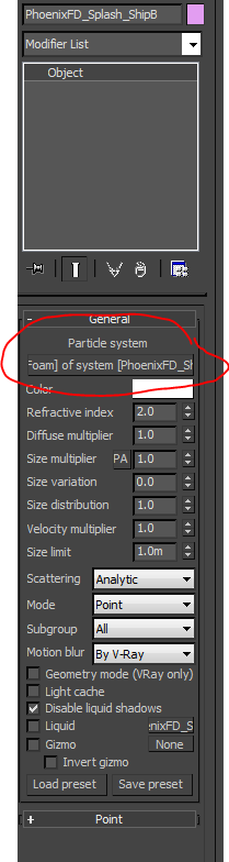

      Thank you so much for the explanation, just was curious what was going. As for putting all the foams and splashes in a single phxfoam I am only given the option to add one particle system to a phxfoam with a pickbox? I see in tutorials on YouTube there is the ability to add more then one to the same phxfoam.But I don't have that on my build of Phoenix or am I missing something? I have included two images of the difference between mine an the one I see on YouTube. Thanks.

        well, can you tell the build number? see it in the about box

          OK here is the info in the about box -
          Phoenix Fluid Dynamics ADV for 3ds Max 2015 / V-Ray 3.x Version: 2.2.0 Revision: 24510
            well, this is the official release, to include multiple objects in one shader you need nightly build. ask the support, they will explain you how to get it.
