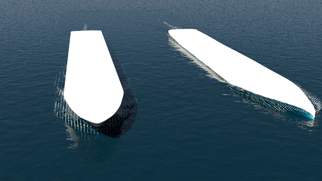

Hello all, I have this strangeness going on with my splash and foam in the nightly builds.(The Liquid seems to working great) The foam is creating some strange grid pattern. Not sure exactly sure how all the new parameters are working with foam and splash, but I tried to keep it all the same as I was doing before. Does any one know why my partials could be not simming properly? I am thinking this is a user error on my part, but not sure. Thank you everyone. I have attached some images if what it is looking like. (The White objects are just simplified sim objects of huge boats)

i think i know what is it. for some reason you have one or more splash particles far away, this is a bug for sure, but you can workaround it. the reason for the particle ordering is the particle compression. the compressor automatically increases the dynamics in order to catch all the values existing in the data, and the far particle disturbs this process, leading to the result you have. so, just disable the particle compression (output panel), also i would like to have the scene, to investigate the problem.______________________________________________

I think disabling the particle compression is working. Thanks! I have uploaded the file for you to dropbox to check out. I tried to strip out all the crap so it is easy to understand, you will notice 8 other Phoenix sim objects that are in there for the other ships. I left them in there encase they are effecting the main sim on the front two boats, but are not related.

today is not my day, after investigating the problem few hours, i released that your simulation is not using the flip core, it's based on the old core. see the advection method, it's classic, must be particle based (flip ). beside this the storage quality is too low, the default value is 14 , 8 is not enough for the particles.Last edited by Ivaylo Katev; 02-09-2015, 05:24 AM.______________________________________________
