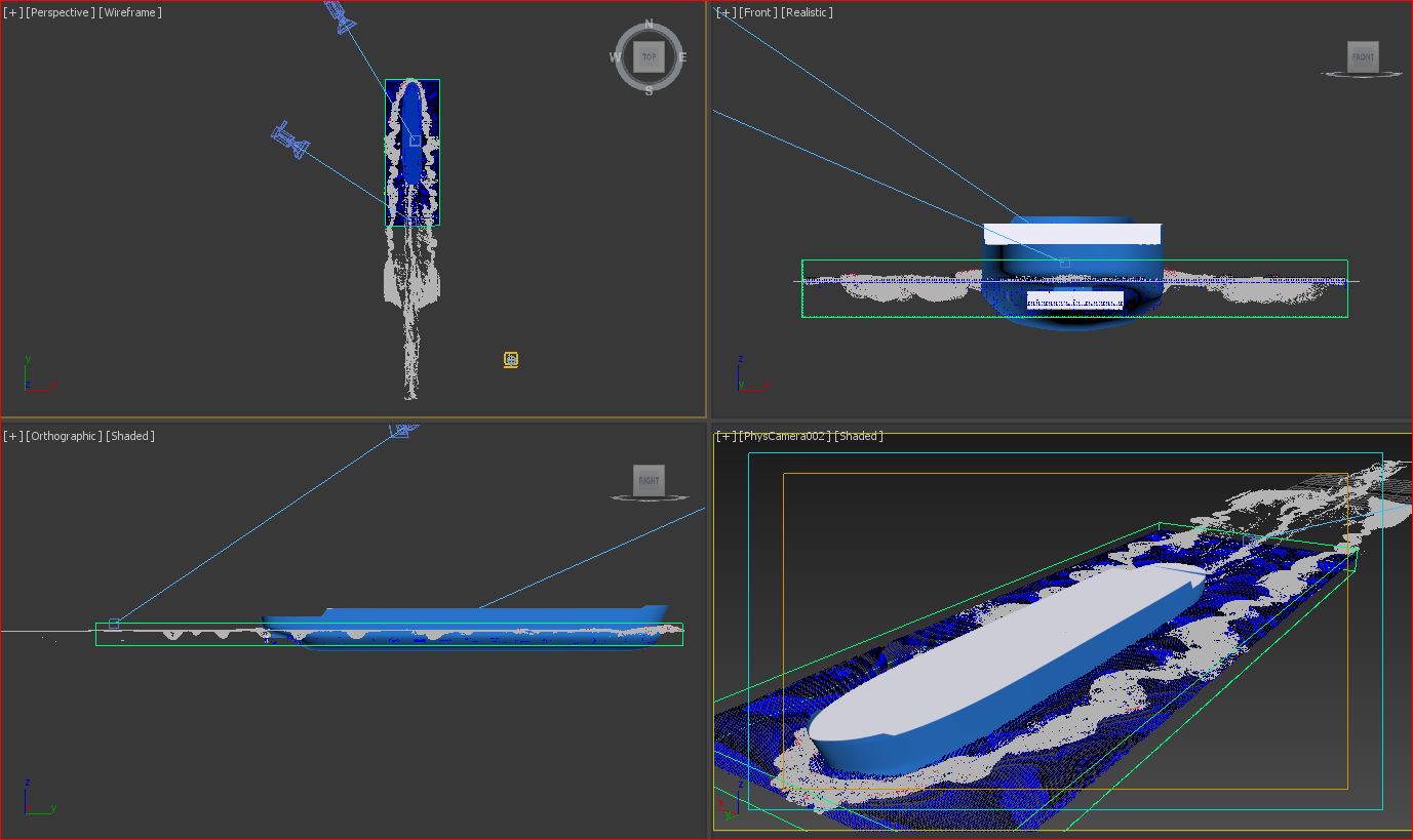

    Take a look at the image below. I don`t understand why the foam particles are cutoff so abruptly at the edge of the simulator box. As I understand the foam should live on for 10 seconds outside the box, and some of the foam particles has done that. Why is there a cutoff for most of the particles? Appreciate any help
    EDIT: The units are in cm and the boat is in the ballpark of 60 meters long. It travels at about 28 knots in this scene. The foam is made with resim on top of an ordinary liquid.

    Hi hardrock_ram,
    The Outside Life parameter is a trap that we have to change - currently what it says is "if the particle exits the grid and its Total age by now is more than X seconds, then kill it". This is the reason for the abrupt cut-off. We have to think about how to fix this behavior.
    Cheers!
      yes, this is a big problem. let me explain more
      to make the outside life behavior as expected, we should add an additional channel containing the life of the particle outside the grid.
      However, each additional channel consumes memory, that is important, we are trying to minimize it. Our solution is to kill the outside foam after it reaches certain age, that is apparently misleading the users, because some particles have this age before exiting the grid, and this produces the sudden drop of particle density on the border. For now, just set a bigger value, we will decide what to do with this trap.

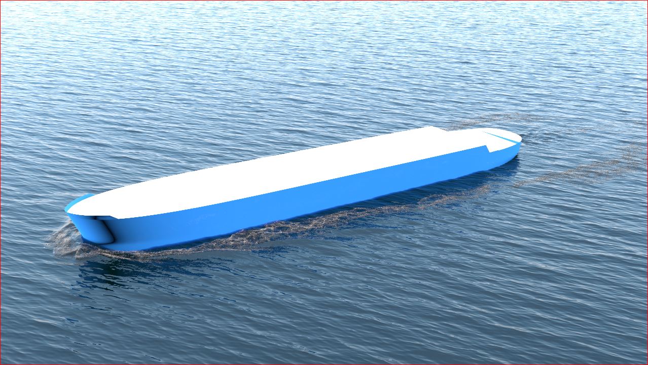

                        re-did simulations with 3.00.02.
                        looks quite different. same frame 1000 I earlier posted example picture of, now look there is either less foam or if it is rendered in point mode (but it's not).
                        I extended the simulation to make sure foam has time to leave simulator and it does through the aft wall ,but I still think it does leave thought the sides.

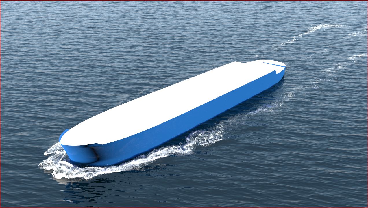

                          Thanks! Will have a look, but before that I think I know what might be causing it - we did some changes related to the new V-Ray adaptive lights that caused problems with 3.00.02 + older versions of V-Ray. Would it be possible to grab a latest nightly where this is resolved for older V-Ray versions as well?
                          • #14
                            as advised did new sim with 3.05.02 Nightly Build ID: 1701207158
                            render looks "normal", as before-v3.00.02
