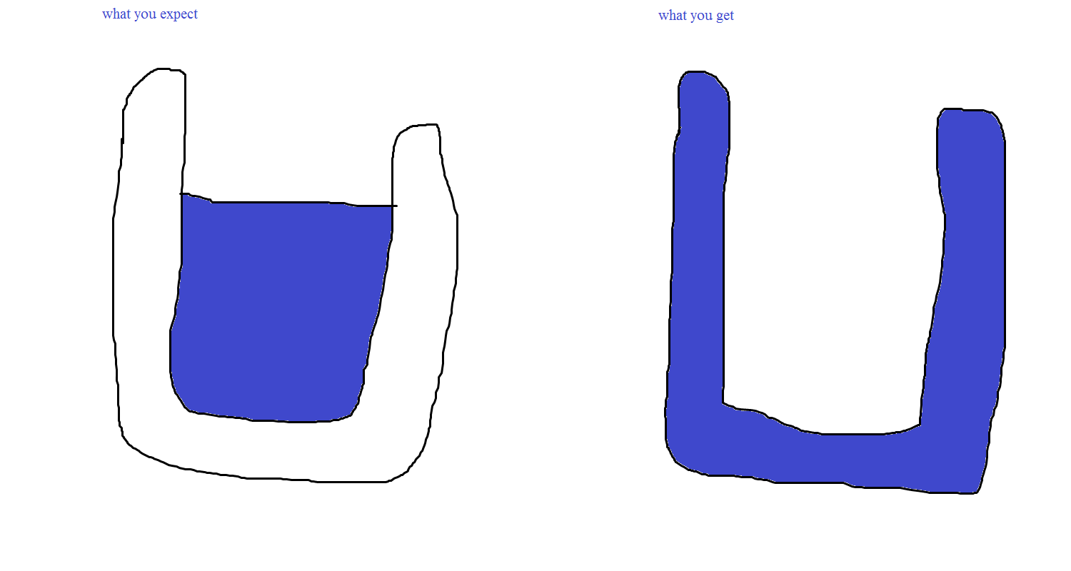

            1) Is it possible to specifiy how much to fill on an object? I have a sort of U shaped riverbed, and it does coat all the walls pretty much equally, but I was wondering if there is a way to have it be solid across from one side to the other?
            2) I probably need to change my (admittedly basic) model to accommodate the new method, because for some reason the initial fill up water doesn't see my river bed as a solid object and immediately drops through the bottom. I tried making the model watertight and then another way of adding a shell to it, but for some reason it just doesn't stick or see the geo as an object. Where did I go wrong? (Or should I use one object to generate the water and another object for collisions?)

              i think you are misunderstanding the fill up functionality.
              it does not fill the object in the common meaning of the word, but in the 3d meaning of the word.
              for example, if you have a glass and select this option, the glass will be not filled, but the walls will be filled.
              with other words, you need to create an invisible object, that specifies the shape that must be filled, not to use the river bed for this

                Ah I see, thank you very much. That makes sense, I did find a teapot fill tutorial somewhere that was similar to this in concept, easy enough. Thank you.
                EDIT: Yes this is really great, super control over where the water spawns. Love it.
