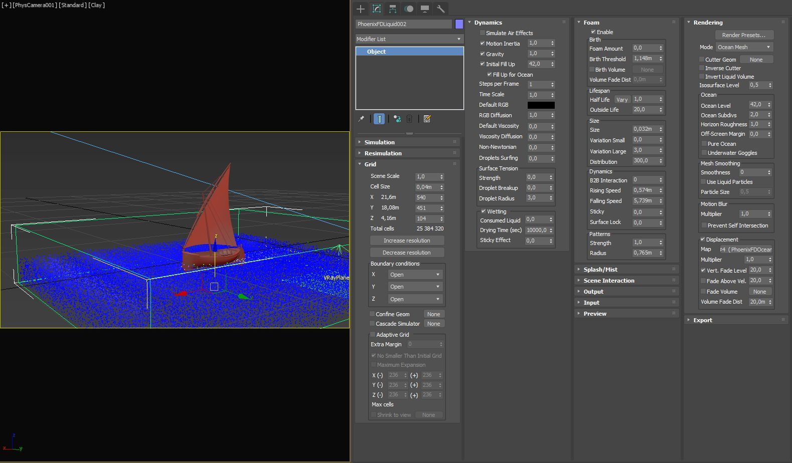

    - Small boats like this have to move with the waves. I know that this cannot be simulated, I would not mind doing it by hand or create differently. What I have not understood yet is the connection to the grid. According to the ship-in-ocean-tutorial the simulation grid is linked to the boat. But when I rotate the boat, the grid rotates and the simulation goes crazy (as I would expect). What would be the usual technique in that case? Not linking and simulating with a much larger grid, increasing the sim time and data?
    - How do I get rid of the seam between grid and infinite ocean. It looks like rectangular object is moved under the surface pushing it up a little. Ocean-level and fill up are the same value.

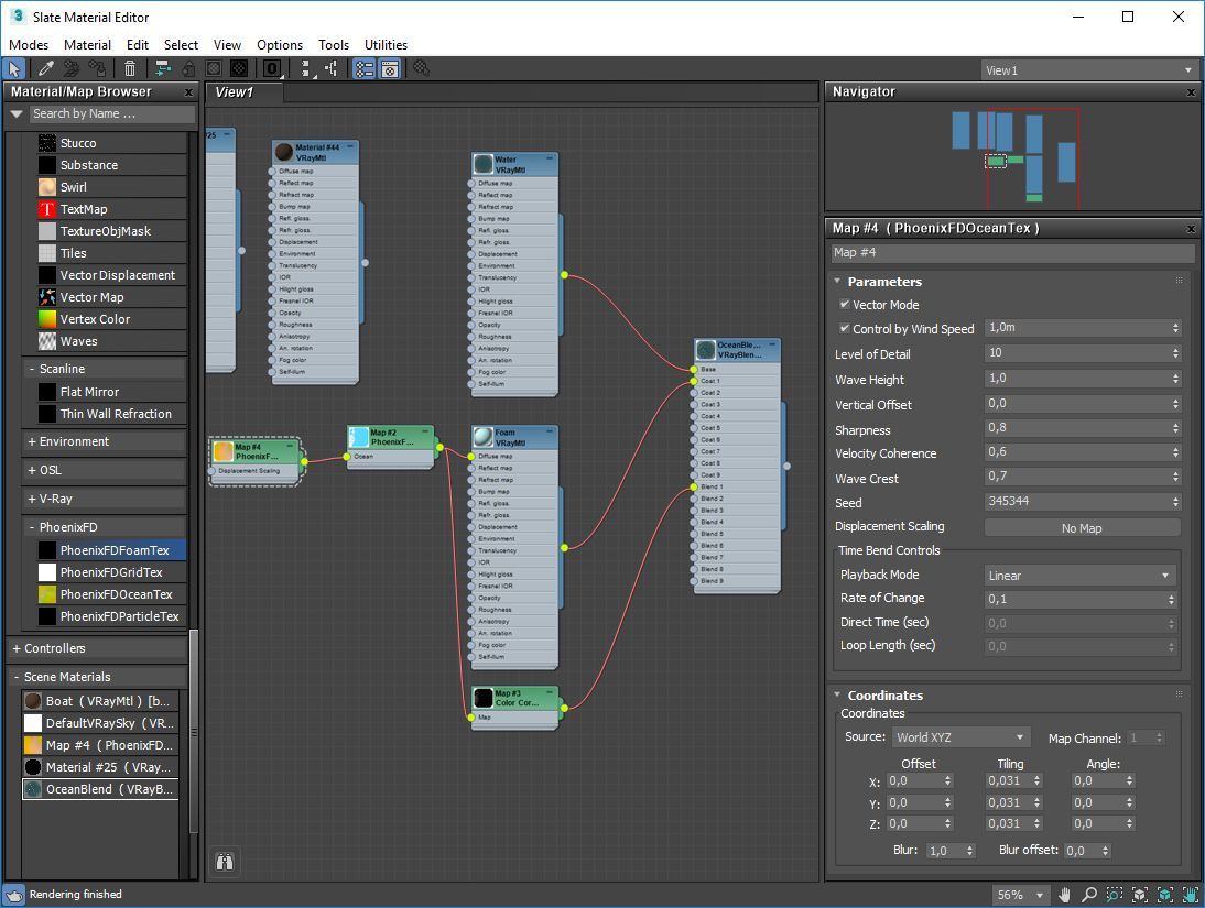

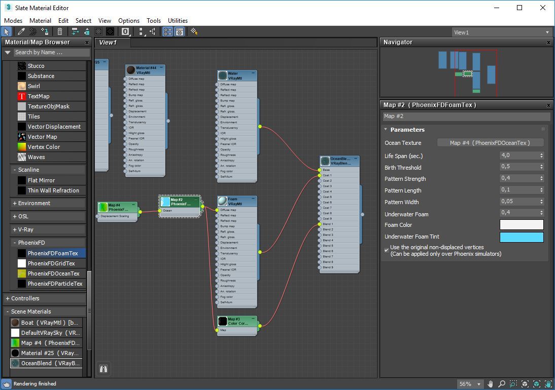

    - The Foamtex does not seem to work, it only produces grainy dots. I noticed the small tiling value in the oceantex (was done by preset, not by me), but when I put it back to one, the foam looks better, but placed wrong, and the waves become way too small. System units is 1m, scene scale 1, boat is to scale (about 7m long).

    Have the grid follow the path of the boat with no rotation... doesn't work well when it rotates (unless this has been fixed recently)
    Adam Trowers
      Hey,
      For the boat animation - you can disable the rotation as flipbook mentioned or as you have guessed unlink the simulator and the boat and make the grid larger.
      For the seam - you can play around with the ocean level - the value doesn't always have to match the fill up (it should be something similar).
      As for the foam - can you send us the scene so we can take a look?

          Set your Tiling for the Ocean texture to 1 and increase your Control by Wind speed to 3 for example (you will have to figure the best value for you) and the Rate of change to 1 - this will compensate for the scaling of the texture.
          This will fix the dots that the Foam texture is making. In order to fix the movement, select the Foam texture and turn off "Use the original non-displaced vertices".

                    This is indeed caused by the movement of the simulator. If you can make the grid large enough, so that it covers the entire path of the boat and it doesn't have to move the problem with the waves should be solved.
