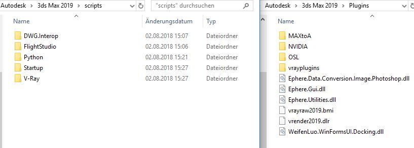

                    Only had berconmaps installed, other than that: Fresh install of a vanilla max. Removing berconmaps also didn't change the outcome for me.
                    Screenshots of my plugin-folders are attached. Just so you can be sure, I haven't overlooked a plug-in
